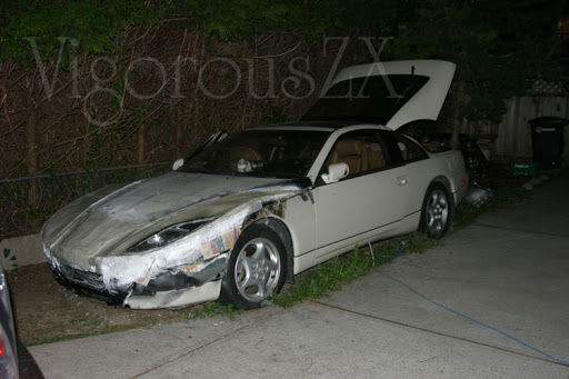

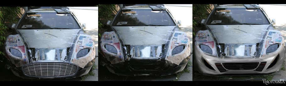

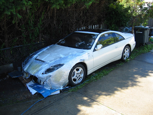

Ive been constructing the Zed for a long time now and I feel I finally got the dimensions down. I made it a little more squared and rounded out the bumper too. I read before that there are DOT regulations on the bumpers strength, so keeping the stock one underneath should satisfy this but it also stops me from cutting the front shorter.

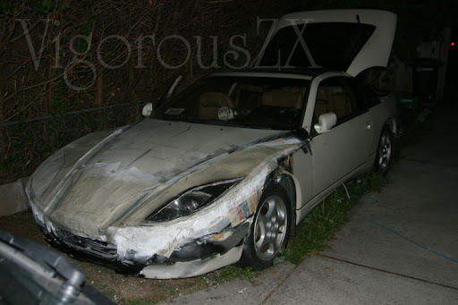

Next week Im going to fiberglass the top panels only then finalize the rest. Once its finished, Ill sand the edges a bit to make it more rounded.
Right now one of the headlights is misaligned which is due to my rushed work, but Ill fix this after the glass is cured.

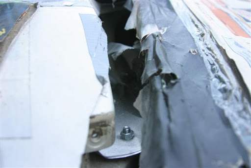

Here is a close up of how I mounted the headlights... its basically sheet metal that is shaped into an L and secured into the existing screws, http://lh6.ggpht.com/_aqdJkNjP_iM/TGaJm ... all%29.JPG
The way I placed the newspaper over top, the car looks like it drank a barrel of oil and got a black mustache. As I was working today I noticed that it kinda looks like a huge grill, then it instantly reminded me of the Aston One-77 concept.

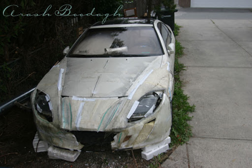

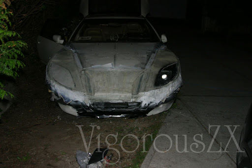

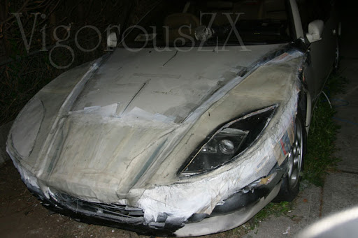

Update
Now the cars top surface is fiberglass-ed and Ive cut out one headlight. My current dilemma is to center the headlights vertically which means either cutting more into the fender and hard metal front frame or bringing the kit forward.
The high-beams are purposely not fully exposed because it just looks better this way and I hardly use them anyway. If I have legal problems with it in the future then I'll have to readjust it.

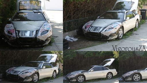

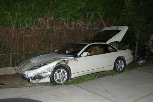

update photos... I was playing with the 240sx today :)
high resolution picture in my miscellaneous album
Im going to be cutting deeper into the fender to position the headlights properly and if its still not good enough, Im going to hack the plastic off the headlights a bit and reseal it with a new smaller enclosure. One concern with doing the latter is that around the bulb there are metal reflectors and these would get trimmed out or moved in. Since new brighter bulbs are available today, removing these metal reflectors shouldnt be a problem.

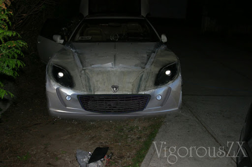

A little teaser pic, Im making the holes for the blinkers and fog lights today
