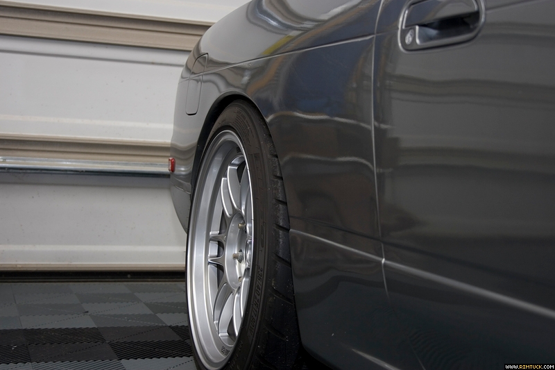

costa_rican13 wrote:would the 526's need a spacer if they were got in the 17x9 +35 to look flush or start poking?
Those will not clear coilovers up front without a spacer (unless you have Megan's with the extended bracket). They'll fit fine in the rear, but not to my definition of flush.
Here's 17x9+35 with 235/40's rears on S13
17x9+33 with 245/40's on S14
If you're wanting cheap mesh wheels with a decent lip sized 17x9's all around, I'd say go with 17x9+20 XXR 006's or the those new 17x9+15 Square G6 wheels...
