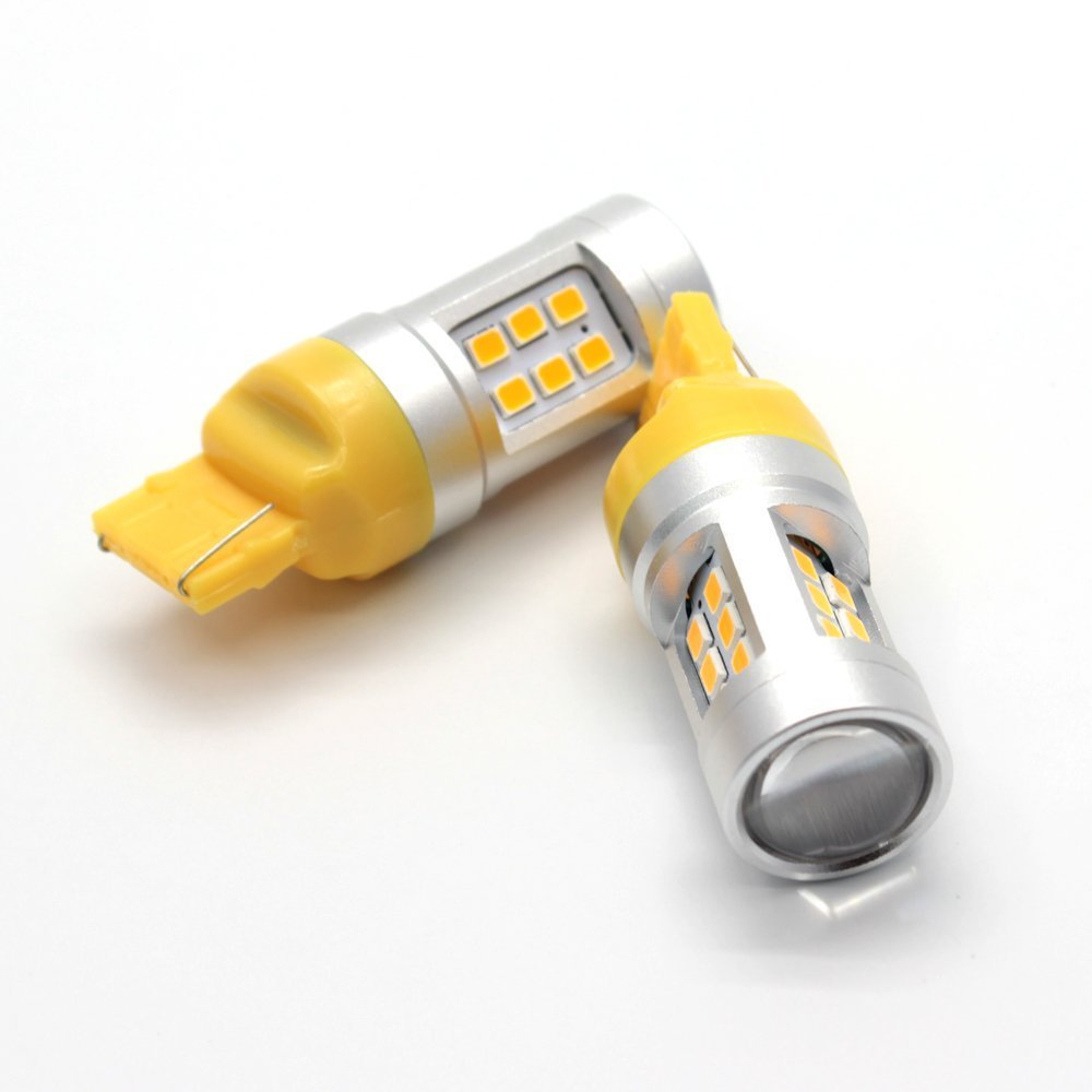

So I am somewhat unhappy with the daytime brightness of the rear turn signals. The fluted lenses seem to dull the color quite a bit in daylight and I feel like other drivers are not being given enough of a warning that I am coming over. The fronts are somewhat better but could use a little more output too since they sit so far inboard. I should be receiving these very promising new bulbs today and will hopefully get them installed and report back with some pics.
They are made and/or marketed by JDM Astar and appear to be primarly sold via Amazon.

I got the bulbs and got them installed. HUGE difference in output. Daytime output pics below. Nighttime output, which is crazy bright, to come.
Front - New on left, old on right
REAR - Old on left, new on right

These super bright turn signal bulbs are on sale right now for $30 a pair down from $50 a pair. Huge 40% savings. They are sold by Amazon HERE.

Mjkkb2 wrote:Are resistors required with those.
Yes. But given how bright they are for I think it's worth it.

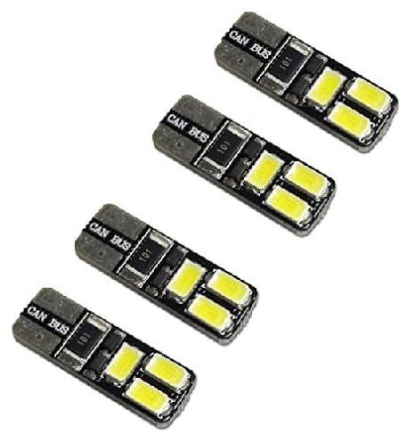

Has anyone figured out exact size needed for licence plate led's?
I have some of these left, but can't close the cover - too tall.

Those bulbs last everywhere on the car fine except when used for the license plate. I think they just don't like being on for that long continuously. I actually tried removing the top led from the last set (by filing off the three pins on each side until it popped off) to see if they were failing from the pressure of the tight fit. Still failed too quick.
I have been running THESE for two months without issue. They fit fine. The only problem I have with them is that they are a warmer white rather than the cool white I prefer but this is my fault for not confirming color temp before ordering.
I'll probably order some cool white versions like THESE later.

just FYI, I ordered these (pictured above) when you first started this thread. I wanted to use them for the license plate and they would not fit. The base was too thin and would not stay snug. They basically fell out from the housing. I also tried them in other interior lamps and same thing happened.

I am using these for the license plate. Cover closes perfectly fine and the LED fits perfect in the socket. They are very bright.
