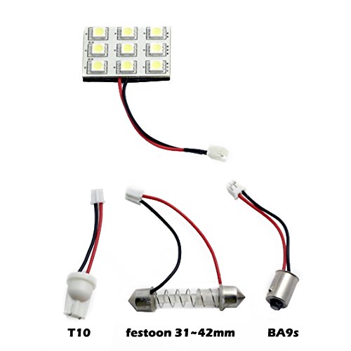

I believe in one of the earlier posts it was explained that one has to splice the wires (no connector/splitter). And they connect backwards (red to black, black to red).
Debonair
Posts: 1109
Joined: Tue Sep 09, 2014 12:58 pm
Car: 2011 Infiniti M56
Location: 408 NOR CAL
withomps44 wrote:Thank you!! forgot I had one more question... How did you get two of the lights together in the front dome light wired up? Is there a splitter I'm missing?
Mjkkb2 wrote:I believe in one of the earlier posts it was explained that one has to splice the wires (no connector/splitter). And they connect backwards (red to black, black to red).
MJkkb2 is correct. I soldered the two reds together and then the two blacks together. Then since the stock bulb in this location is reverse polarity I wired the two reds to the bulb base black, and the two blacks to the bulb base red.

Ok. So I'm going to solder my light panels together red to red and black to black... then cut the wires running to the BA9S and solder them back red to black?

this is what I have done.
1. take two T10 connectors, pull out the ends (T10 side) and discard it. You will be left with two sets of connectors with bare wires one end and plastic connector the other end.
2. connect (solder preferably but not necessarily) two reds together and two blacks together. You will end up with a double connector with bare red and black one end and two plastic connectors the other end.
3. connect one panel light to one of the double connector clips, connect second panel light to the other conn clip. You will be left with two panel lights connected (parallel) with double bare red and black wires on the other end.
4. Take the BA9 connector and remove the plastic clip/end and discard it. Connect double red wire end from the panel lights to the black wire of the Ba9, connect double red wire to the ba9 black wire (solder preferably but not required).
Plug the Ba9 into the dome light socket. Done.
You can also forgo reusing the extra connectors and just remove all the white clips and solder the wires together. You can also connect the panels in series instead of parallel. The possibility are endless :biggrin: . I have not soldered mine, just twisted them together and taped them with electrical tape. Have been working so far without issues.

Those instructions are pretty much spot on. I left the connector on because I was not sure if I was going to be happy with the output. Since I have guinea-pig'ed it for you you can just solder everything together. :biggrin:
Also when I tested them prior to soldering they did not work in series configuration, only in parallel.

I did all of them but can't get my front dome's to work...no matter how i place the bulb.... argh1
Debonair
Posts: 1109
parkstr8r wrote:I did all of them but can't get my front dome's to work...no matter how i place the bulb.... argh1
They need to be reverse polarity. If you are using an LED panel like I did hook the red wire(s) to the black wire on the socket part and the black wire(s) to the red wired on the socket part.
Also make sure the 'dome light off' button is not pressed.
