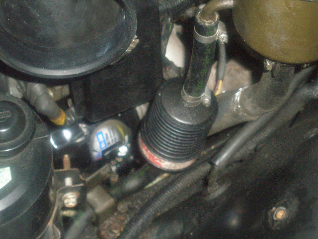

Well I couldn't fix the electrical problem so I took a break and installed the Magnefine filter today on the return line for the power steering. It was a scary experience because all my life my parents doubted me and told me to let others do the things for me ("because they know more"). But I got it on.
I was cared at the fact after re assembly I heard the power steering pump whine and I shut it off after a 1/2 a second of hearing it. But I assume thats far to late so I will be bleeding the system tommorow to make sure there is no air in there. I will also re check the fittings on the power steering lines as well as look for puddles.
But my only fear is the filter breaking the plastic case that is. Do you guys think thats at all possible if you change it every year?
Either way I am holding off on putting a Magnefine filter on the A/T till I am satisfied with the current. And because a power steering pump and rack is far less than a new or used transmission installed.

Sorry to bring this up YET AGAIN (I know, I know) but since I changed the oil yesterday (Fun day) I didn't screw down the OEM intake (It started raining out of no where) so I had to do it today. I also snapped some pictures for my NICO friends:
http://picasaweb.google.com/lh/photo/zO ... directlink
http://picasaweb.google.com/lh/photo/85 ... directlink
http://picasaweb.google.com/lh/photo/tG ... directlink
The above is the power steering filter, I still need to install the filter for the transmission. And possibly a bigger power steering cooler.
Please pardon the disgusting filthy engine bay, I need to get around to cleaning it

I installed the Magenefine filter onto the transmission lines today after checking it over 10 times. I drove with no radio, sunroof and drivers window open and the under engine cover off all the way home to be sure I got it right. The funny thing is that the wheel well trim came off and dragged on the ground. I thought something went wrong with the transmission filter and I pulled over right away. Looked under saw the piece hanging. Still pissed but not as much.
I called up Magnefine themselves and a Tech did say the filter could be installed backwards and still not restrict flow (Bypass Valve AKA idiot valve)
Good news is doing a oil change is not that hard on this car with the car on the ground. The under engine cover makes everything harder though.
The line direction is listed in the service manual. It would be interesting to install a gauge before and after the filter to see if their is any increased back-pressure by the filter. The person I spoke with on the phone says its like adding another foot of rubber hose to the system.
