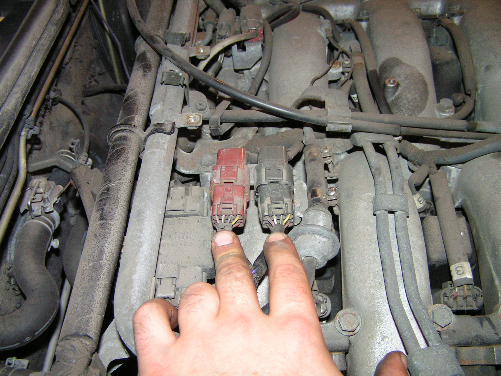

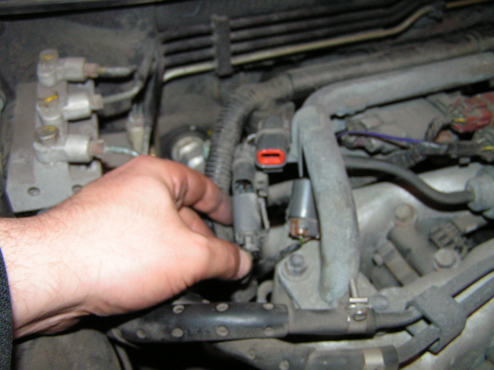

i'd really appreciate it if you can take the time to snap a photo for me, the links to the photo that i need is in my last post above, i just need to know if there is an external wire that is connected to the injector harness, thank you
