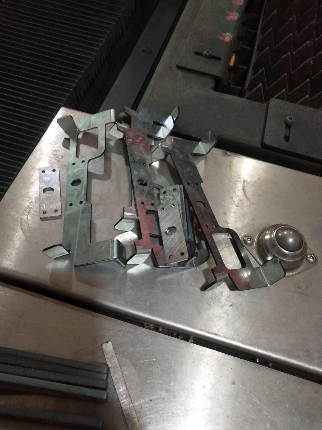

I am working on my own version of the bracket. Let's see what the result would be. 130$ for the bracket is too much. I have figured out all the necessary lengths.

how did you make this? would you mind posting once you get it? i agree, $130 is way too much, especially considering you still have to buy all the paddles and trim pieces too

I just used corel draw to measure all the lengths of that bracket. I first cut the model on a paper, I did it like 10 times until I get the perfect match. At the end I took the paper model to a person who works with iron and steel, and he cut the model from the steel. Thats it. 20$ overall.

Guys here is the file corel Draw file where all the measures worked for my infiniti M56. I have redone it 10 times to get the exact size so now it fits perfectly. Hope this will help you guys.

Thanks a lot! The file is good, may I ask how much is the thickness?

You're welcome. Forgot to measure the thickness but it was around 2-3 milimeters.

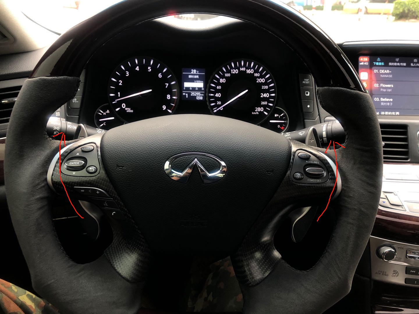

Hi, I just follow your Corel Draw file to made the bracket for the paddle shifter, I think the position is a bit lower.
I want to make the paddle shifter a little higher but I don't know would it fit for the shell under the steering wheel. Please guide me, thanks a lot.

No they don't, those are just bigger paddles. That's the only way to sit the paddles higher than the stock location.

I just made the bracket, but the plastic cover of steering wheel didn't fit for the paddle shifter.

Here is the part number. Just search around online to find the best price.
48470-1MA2B
I found it for $157 shipped when a dealership was having a sale.
