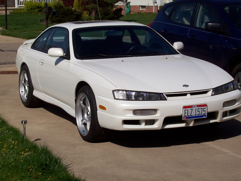

(bad shot, but you get the idea)

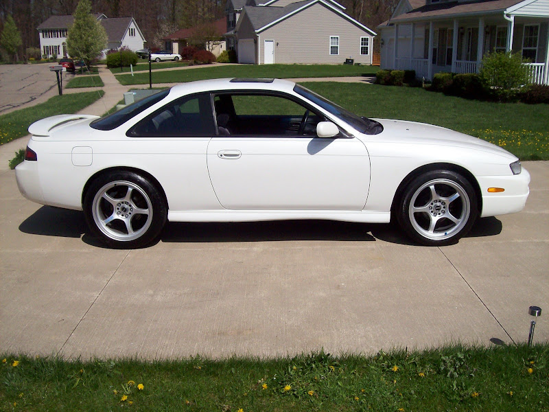

My wheels are very thin spoke, so they make the brake very visable... making the attractiveness of the caliper and rotors something to show off.
Course, this picture has some shading that doesn't really show the brakes, but you can tell from the wheels that the brakes will be very visable.

some white z32's would look awfully sexy behind those gram lights...

numbnuts240 wrote:some white z32's would look awfully sexy behind those gram lights...
I completely agree!
I'm going to look into powder coating options.
