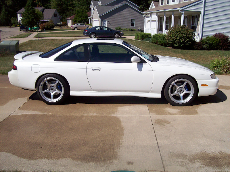

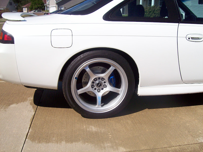

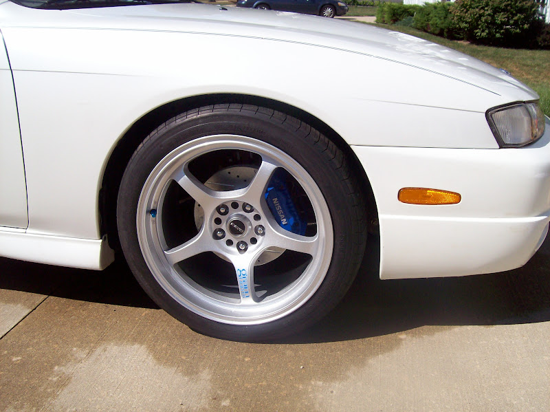

After a very very very busy summer, I finally found some time to get my brake upgrade done (well mostly).
I had some problems along the way.. like the bolt at the end of the brake hard-line rounding off, the front TC rod bolt I rounded off, and I had to replace a ball joint. But, the biggest problem I had was that I have just been swamped with school and life for the past few months.
The only think I have left is ebrake cables. The car is an automatic, so I can go without ebrakes functioning for a while. I am going to have to replace the front ebrake cable because the connector is in pretty crappy shape.. then I have to get either an adaptor or R33 cables to get them hooked up for good.

r33 cables are so much easier than mucking about with z32 2+2 cables, you're better off selling those cables to an s13 guy.
trust me, been there done that...
looks good otherwise and should be worth it when done, every time i drive a schassis with stock front brakes i feel like im gonna die when trying to stop fast; pulling a car down from 100 to 55 is no easy feat with stockers.

those breaks look sexy back there. they still look a little small in the wheels though but a huge improvement from the stockers. good lookin man.
carl, i know what you mean about trying to stop fast with stock brakes. then after coming down a mountain road your brakes get warped. lol junk for brakes.

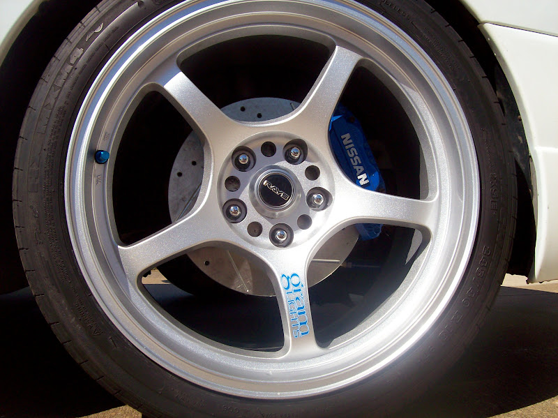

no kidding.. they do look small behind those wheels... They are 18"s, but gram lights have pretty small spokes so they show a lot of brakes.
If I ever need to replace the front rotors, I think I'll go with the slightly larger 350z rotors and the relocation bracket for the Z32 calipers.
