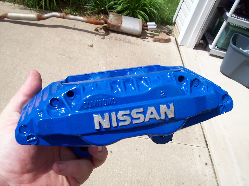

Step 5 - base coat of blue. Decided it was stupid to do all the work to tape off the raised lettering.. since the base aluminum on the lettering shined up nicely anyway. So I just shot the whole thing blue and then used an exacto knife to peel away the paint off the raised lettering. Then I shot them with 4 coats of VHT Clear Engine Block enamel to bring out the shine!!! Sadly no sunlight today to show off the shine.
So my prep work is done... Nothing more happening today, or for the next week actually. I have to study for finals, which are next week. Plus, I'm heading to NICO's meet at Carlisle, PA tomorrow morning. So, I'll probably start doing the actual install next weekend.

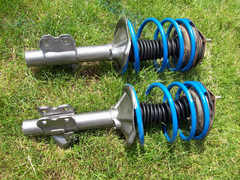

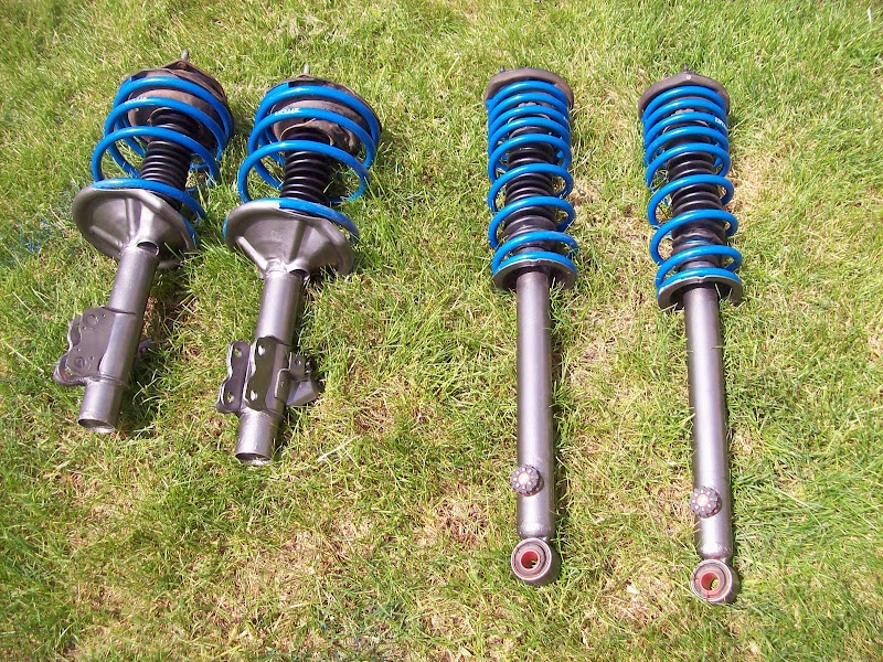

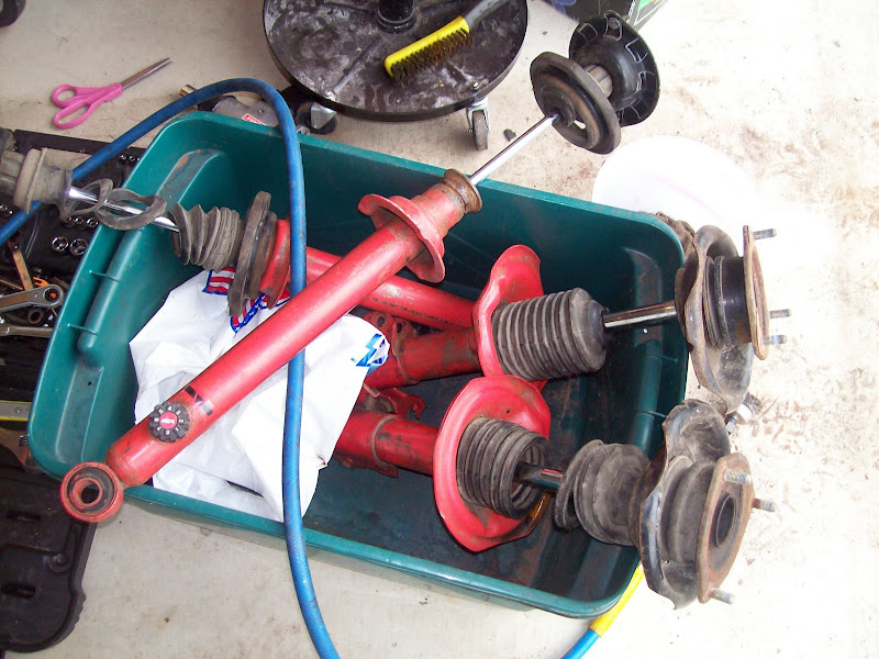

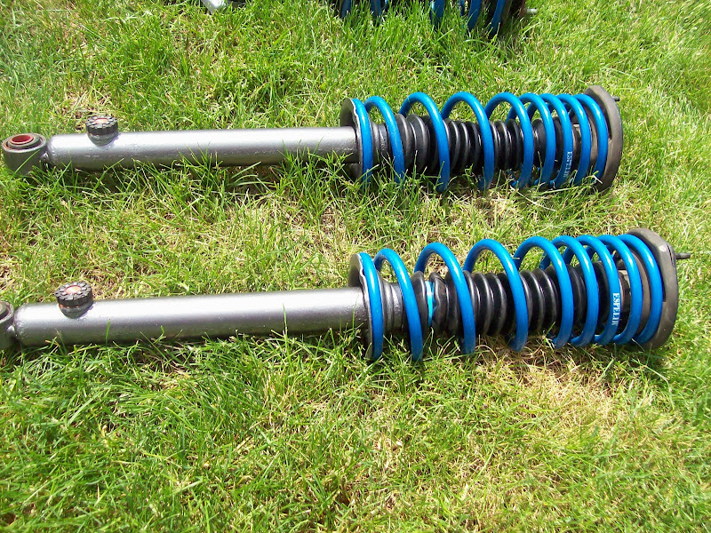

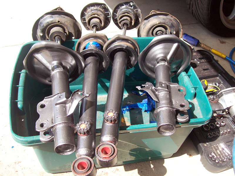

I acquired a set of KYB AGX shocks from a local guy for $200. Not too shabby... They are certainly used, and quite dirty...
This picture is after a thorough cleaning..
I'm trying to keep this car as clean as possible, so I decided even cleaned up a bit, there were still pretty nasty looking.
I had a can of gunmetal metallic alloy wheel paint sitting in the garage that I decided to use on them. They look much better... The camera doesn't really catch the metallic sparkle very well... and I suppose buried under the car, they never will show off much... but at least I feel good having them look nice.
I picked up a set of espelier springs a month ago for $110 shipped.. I guess they had only a few miles on them and the guy decided to go with coils for a lower stance.. These are 1" rear and 1.2" front drops.. plenty for my taste.

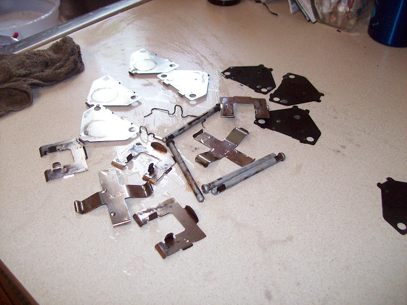

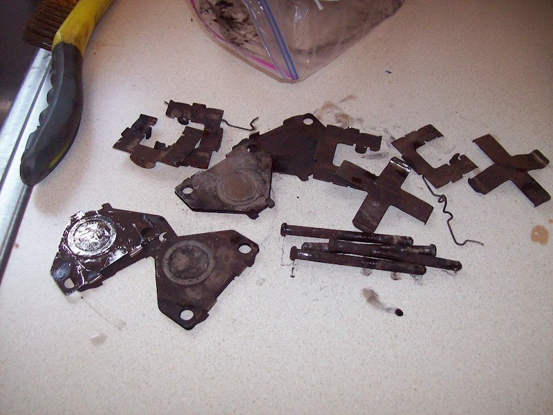

But first... Must clean hardware

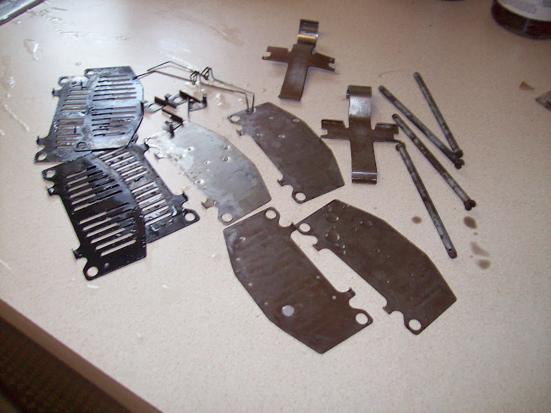

Before:
After:
They aren't perfect, but much cleaner than before. I feel better about putting them back together with decent hardware.

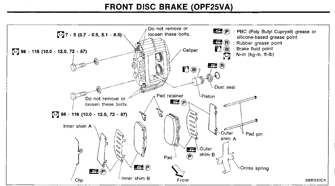

Next step... pad and hardware assembly. I stared at them for a while trying to figure out how all those parts go back together.. Finally decided it was worth pulling the FSM for correct instructions.
Here is the FSM picture for future reference for anyone else who might need it.

wow those springs and shocks came out nice. i did that once with some kyb gr2's i had for the rear. they had like over spray and a bunch of grime on them. they turned out looking real nice. about 6 months later it looked like i never touched them lol. hope i didnt bust your bubble but i wont be doing that again. lol
i have never heard of the springs before. are the a decent brand?
Eikon
Posts: 6928
Car: 71 240z, 93 Supra TT
Location: Lake Orion, MI
lol.. yeah, I'm not expecting them to stay pretty for very long... haha.. They will look nice for my install pictures at least. I didn't spend anything on the clean up project (well.. $3 each for the dust boots).. I already had the can of paint in the garage, so no big deal if they get nasty again soon after putting on the car.
The dust boots were a very necessary and worthwhile job though.
Espelir is a pretty high end spring what i've read. They were almost $300 new I guess. I've read some good reviews online about them. I guess I know for sure in a little while. lol.
