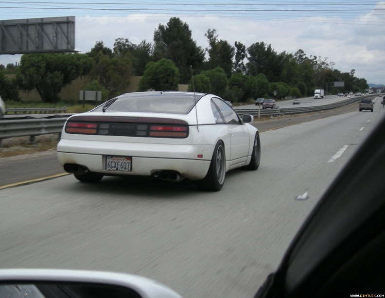

BigTDogg (MA) wrote:IMHO, avoid Rimtuck,
I'm gonna go ahead and disagree with this statement.
OP, it can't hurt to take a look at as many setups as possible so that you can make your own decision on what kind of wheel/tire fitment you want for yourself. Educate yourself on the subject so you can make your own decision.
Rimtuck is just a tool for understanding & achieving a certain style. How you use that tool is up to you. Don't be so quick to just accept someone's word as the only way to do a certain thing.

Double-A wrote:Haha thanks. Didnt really find what I was looking for on Rimtuck but I found some wheels I might be interested in. They're the Enkei RPF1s. They look pretty nice, lightweight, and they have them in the size I want(17x9 +35).
I guess that 17x10 with 275 rubber all around RPF1 setup wasn't to your liking. Oh well. Good luck, new guy.
With no mods? What off set?
simmode1 wrote: I guess that 17x10 with 275 rubber all around RPF1 setup wasn't to your liking. Oh well. Good luck, new guy.
Very few mods. Roll and slight pull, fender bracket hammered flat, bumper by fender arch trimmed. +15 effective. Not a harsh modification set at all, and looks really good.
http://www.rimtuck.com/setup.php?id=231

Ace2cool wrote:Very few mods. Roll and slight pull, fender bracket hammered flat, bumper by fender arch trimmed. +15 effective. Not a harsh modification set at all, and looks really good.
Not worth it for me as there are plenty of other options to fit that much meat with no modifications. But to each their own.

^^^Understood. But for the OP's benefit, that setup was really more about not only fitting the desired amount of rubber & wheel, but also achieving a certain relation of the curvature of the tire's sidewall to the fender to go for flush fitment. Certainly, it isn't for everybody. Just an example worth noting in case it draws someone's interest.
