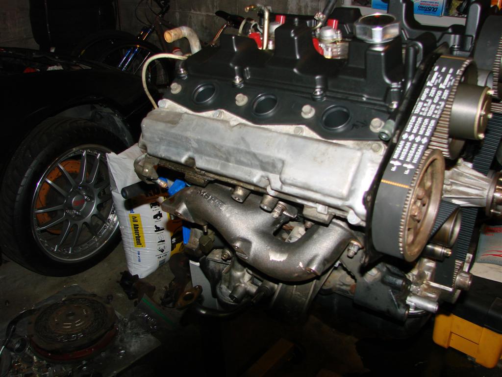

NolimitZ32 wrote:Image Image
:drool: :drool: :drool: :drool: :drool: :drool: :drool:

I did have to mod the DS setup a bit, I bought extended studs for the turdine inducer flange and a second flange, then sandwiched the extra flange with a second gasket between the manifold outlet and the turbo. I had to do this because the compressor housing was too big or rather because these manifolds curve too wide at that one spot. MSPs are definitely the best manifolds out there for these cars. you could also port your stockers, I will be doing msps one day, when I return to the good old US of A, I bought these cause they were $75 and I wanted to see how they worked out, these manis are ok but the fabrication is not upto my standards and one of the nuts for the header stud was impossible to install so I'm running around with a little exhaust leak.
Spec: I could but you have google too, :gapteeth: try searching the Z1 site and the sz site in the galleries. shouldnt be too hard to fin GT28R = gt2560, GT28RS = gt2860
Aaron, thank you man, I do that everytime I look at these pics, not sure if you've figured out but I'm 30k miles away for the better part of the next 4 years while the Z she sits in wait.
