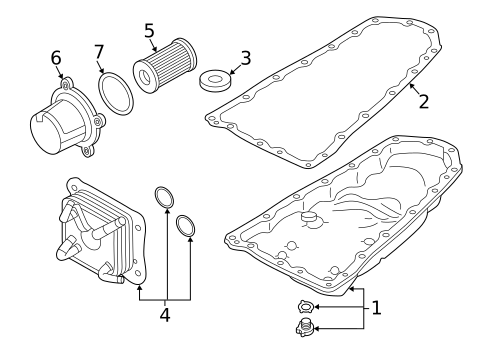

@VStar650CL, anyone,
Can someone please help me. I can't figure out what's the part # of the number 7 on the photo below. I need this part # for my 2021 Nissan Rogue AWD.
VIN #JN8AT3DD3MW300634
I have the part# 31526-3VX0A but it doesn't fit my Rogue.
Thank you
VStar650CL
Technical Expert
Posts: 12096
2004 Nissan Altima 2.5 S
The GE series transmission in your '21 doesn't have the filter where that diagram shows, it's underneath the beehive like the old '10A tran-nies. The '21 beehives are unique, and as far as I know you need to buy the whole beehive to get the factory o-rings. The one and only time I went through this with a customer, he ended up matching-up a viton ring from the parts store.
Boulder.rogue
Posts: 8
Joined: Sat Jun 24, 2023 8:22 pm
Car: 2021 Nissan Rogue
VStar650CL wrote:
Wed Jul 23, 2025 6:30 pm
Thank you sir

D1dad
Posts: 494
Joined: Thu Apr 01, 2021 5:38 am
Car: 2021 Nissan Altima SR
2018 Nissan Rogue Midnight
2009 Nissan Altima SL
FWIW, my filter didn’t come with an Oring so I reused the old which was in like new shape. That was 30k ago.
