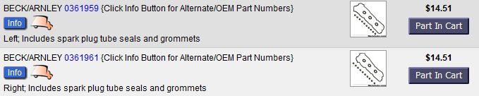

I'm planning to replace my leaky valve cover gaskets - 2001 Pathfinder, 195k mi. Aside from the gasket kits which include the plug seals and grommets, are there other parts I will need or are recommended to replace at the same time? I have RTV, my spark plugs are still young and I've not had any issue with ignition, so I think the coils are fine.

Check out my post here for thoughts on parts and heads up, though Upgrayedd summed it pretty well. Also, I would highly recommend getting OEM gaskets instead of the Beck/Arnley you're looking at. I had bought Fel-Pro originally which is usually a top-notch brand but also got some OEMs on a hunch. The OEMs were made from much softer rubber (more pliable), had a broader contact surface, and was designed such that they stuck in the valve cover, even after flipping them over. This meant that I didn't have to use any product to hold them in place while installing them. The Fel-Pros also had some messy manufacturing that made me concerned they'd end up leaking. Check out my post here to see what I'm talking about, specifically.
