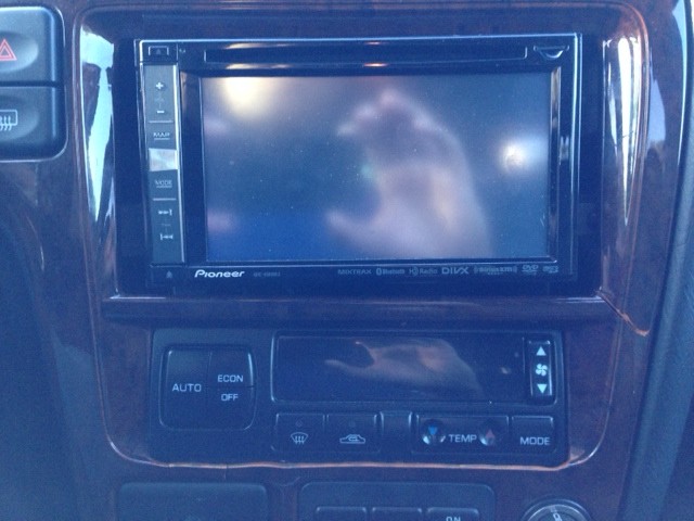

Cvas, I just completed the swap on the weekend, only in my instance I started with a non navi qx4 with an after market pioneer navi on bottom. I have now installed a bezel from a qx4 with navi and moved my pioneer unit to the top. I was able to fit my unit there, so some will fit.
Here's how mine looks right now, still need to fill the gap around the head unit, I also installed my cb radio at the same time. Image

I have the same style bezel as PatQX4, and also had to slightly expand the lower part to fit the climate control.
I purchased a Clarion NX702 head unit and was able to get it to fit, but that system had a lot of problems so I returned it. I'm surviving with an in-dash Nexus 7 tablet paired via bluetooth to a hidden Sony head unit. Parts of it work great - I use google play and pandora and the steering wheel controls are fully functional. And Waze is great when traveling. I'll snap some photos when my car is running again, i have the ECM out for repair.

2. WHAT DID YOU USE??? TO TRIM out the din opening for A/C CONTROL, so controls fit in bezel opening?
2. What can be used to TRIM out NAV ?.
THANK YOU
patqx4
Posts: 187
Joined: Sun Oct 31, 2010 3:53 am
Car: 2002 QX4
Location: Halifax, NS
cvas wrote:1. What A/C CONTROLS did you find that fit bezel opening.??
THANK YOU
1. You should be able to clearly see in my picture that I used the same 01-04 pathfinder auto climate control as everyone else in this thread.
2. Utility knife.
