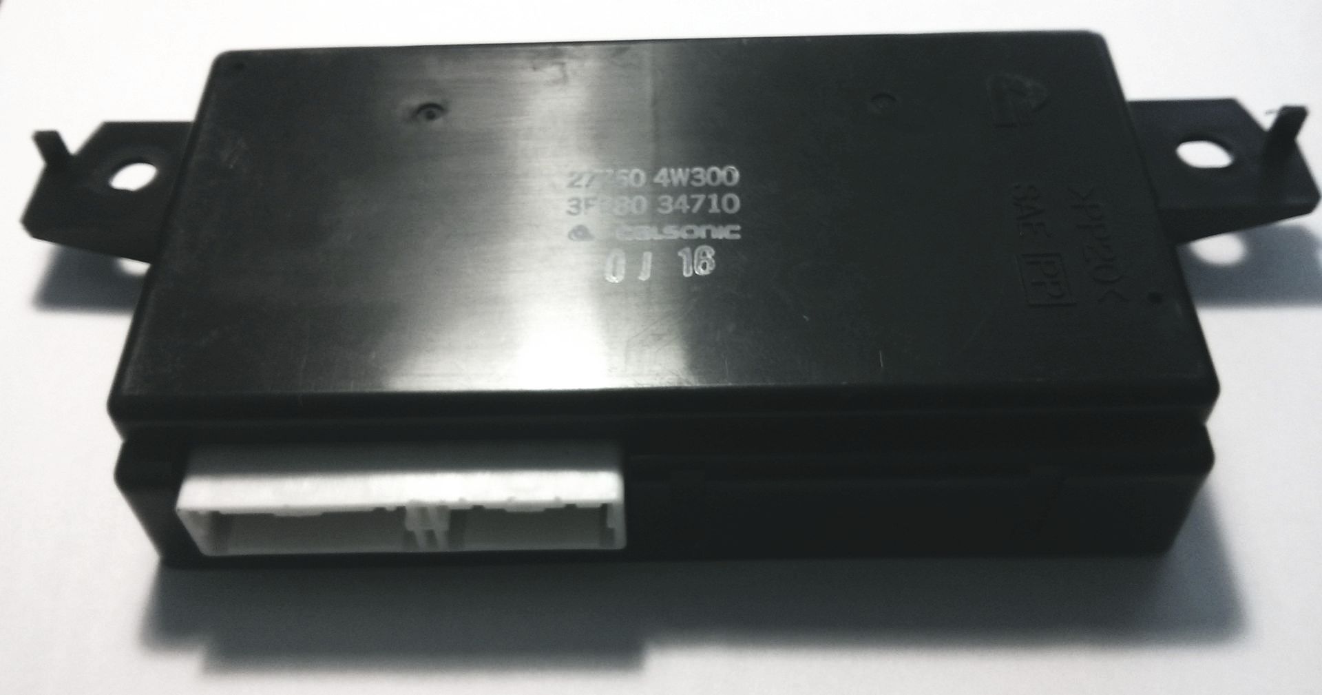

PathfinderSilv02
Posts: 1
Joined: Sun May 29, 2016 7:13 pm
Car: 2002 Nissan Pathfinder
Darkstonian wrote:Hey, all you guys that have done this, do any of you still have the black box from the navi climate control. Mines crapped out, and I'm desperately looking for one. Got as close as to a junkyard saying they had one for $40, but it actually was already gone when I got there, and I'm freezing in Jersey...
I have the same question, does anyone have their black box left over that they do not need anymore? Mine is not functioning properly and AC would really help now until I can find the correct wire harnesses to complete the conversion to get rid of the old navigation.
Thanks
gporter
Posts: 6
Joined: Fri Jun 17, 2016 7:37 am
Car: 2002 pathfinder
Thanks
I just did this project on my 02 last weekend - shoot me a message if you want my black box. First offer gets it.

OK. I found the mystery black box (AC Amp) and its 16/20 PIN connectors. The wires disappear deep into the bowels of the dash.
The discarded Nav Unit had two 20 PIN connectors. The wiring harness also descents into the dash. Each wire, except for those for the window defrost, now has a male connectors.
The salvage Climate Control display has 16/20 PIN connectors. It came with AMP plugs and short wires, which now have insulated individual female connectors.
Lots of wires. How do they interconnect?
Does the Non-Nav display connect directly to the AC Amp, with the old wiring to the NAV unit redundant?

If you've removed your navigation system you no longer need that "mystery black box", as the one you picked up from salvage serves the same purpose, but adds the buttons that were emulated on the nav uit.
Your challenge now is to take the wiring that plugs into the "with navigation climate control/mystery black box", and splice that into the plugs that came with your salvage climate control. The wiring colors should pretty much match up between the two. If you scroll back to page 4 of this thread you'll find a couple messages that 01Path and I traded when he was tackling the same challenge.
If I recall correctly, the plugs that went to the nav unit will no longer be used and do not need to be adapted to anything.
