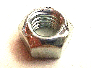

I just mean the nuts on most suspension arms (I think the FSM just means the nut, not the bolt as well, not sure). I realized, when looking up the specs so I can put the proper preload on my rear bushings, that a lot of them do, such as the nut on the ruca eccentric bolt, and the nut on the inner end of the lower link, the nut that holds the rear strut to the knuckle, etc.
Crimp lock?
And yeah, I nead to replace my front eccentrics and the other coilover bolts, the first time I had them out I was stupid and whacked them out with a 2x4, to free them.... naturally, it screwed up the threads, though they still hold the proper torque.
How should I go about shopping for the right kind of nuts/bolts? are there different hardness/elestacity grades or anything like that, or does bolt grade refer strictly to quality? If I just buy the best a hardware store has, would it be bad for this? I really don't want to custom order every bolt I ever break, I'd like to have a stock on hand that I know will be high quality and safe for anything I need.
PapaSmurf2k3
Site Admin
Posts: 19000
Location: Merrimack, NH
mechanicalmoron wrote:
Crimp lock?
Basically the nut has been deformed to keep pressure on the threads, and not back out during service if for some reason it wasn't torqued properly. Its a means to prevent catastrophic failure/death.
Its an alternative to something with say a nylon ring in it. Nylon rings can wear out or overheat and melt. They are also sometimes more expensive.
