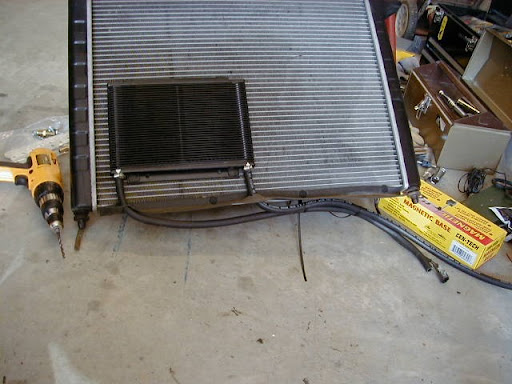

OwnerCS wrote:I have a Hayden 243012 tran cooler already purchased that I want to use before the weather warms up. However, I need to make the aux cooler so that it cannot be seen from under the hood or be easily detectable by some future car show judge...
Here's how I installed my B&M. I even used to black rubber RTV around the hoses where they go through the flap on the bottom. This view is of the front of the radiator, so the cooler is sandwiched between the cooler and a/c condenser. It's totally invisible with all of the trim in place. I don't have any pics. of how it's tied together under the car, but I was able to use barbed brass couplings and tie into the factory hoses at some point where they were joined, and cable tied them on to one of those diagonal cross members that holds the tension rods...
The B&M uses some sort of "stacked plate" design that is supposed to redirect cold fluid back to the transmission without feeding it through the fins, and in our ambient temperatures I figured that was OK. In colder climates, I always envisioned some sort of bypass system that would send the ATF back to the factory "heater" using a series of ball valves.

This is exactly what I had in mind..
It looks like the neighborhood parts stores are getting a premium price for it without any installation kit compared to B&M that has most of what you need..
I guess they figure you should pay extra for the kit because cool is spelled "kool" [sic]and the product is named "Imperial" to project an image of entitlement. LOL
