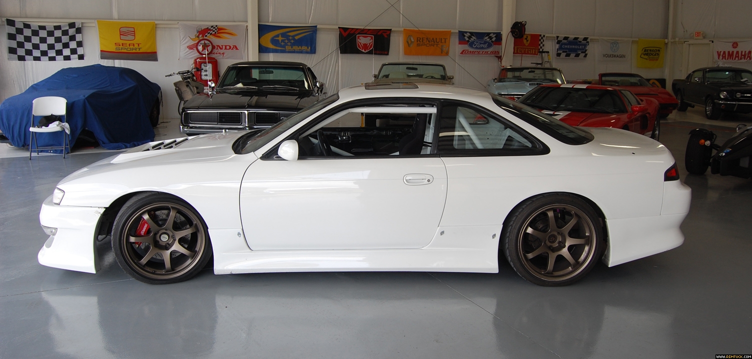

See your stance looks good and it looks functional. What do you have done to your suspension and how hard was it to achieve your goals, there?
These are 17x9 all the way around and im happy with this look. could this be achieved with only coilovers to start?

Thanks,
The rear at the time of the picture was only RUCA's and Coilovers. However I went lower and it required for myself to get rear toe links.
It's not to hard, just trial and error depending on the rim specs you get.
EDIT: 17x9, depending on the offset say, +12. You can fit with just coilovers, however i'd recommend RUCAs if you can also.

simmode1 wrote:
Ridiculous Wobble wrote:Ya well i'm ballin on a budget as of right now even tho the car looks like money, i cant afford tires every 6 months for some 18x11's lmao
Will consider 17x10 rear and 17x9 Front tho.. +20 rear +12 front
There's no 'balling' involved in the setup I have in mind. What is involved? XXR + Megan...LOL
I'll let you in on a little secret that brings it all together:
But you're thinking smart though. Thats a decent setup you just mentioned. Do that. I say 17x10 up front lightly, but seriously, that sh*t is NOT for beginners, the faint of heart or those who lack determination.
What are those in ur pic exactly? looks like the base of the front shock but i cant tell.
