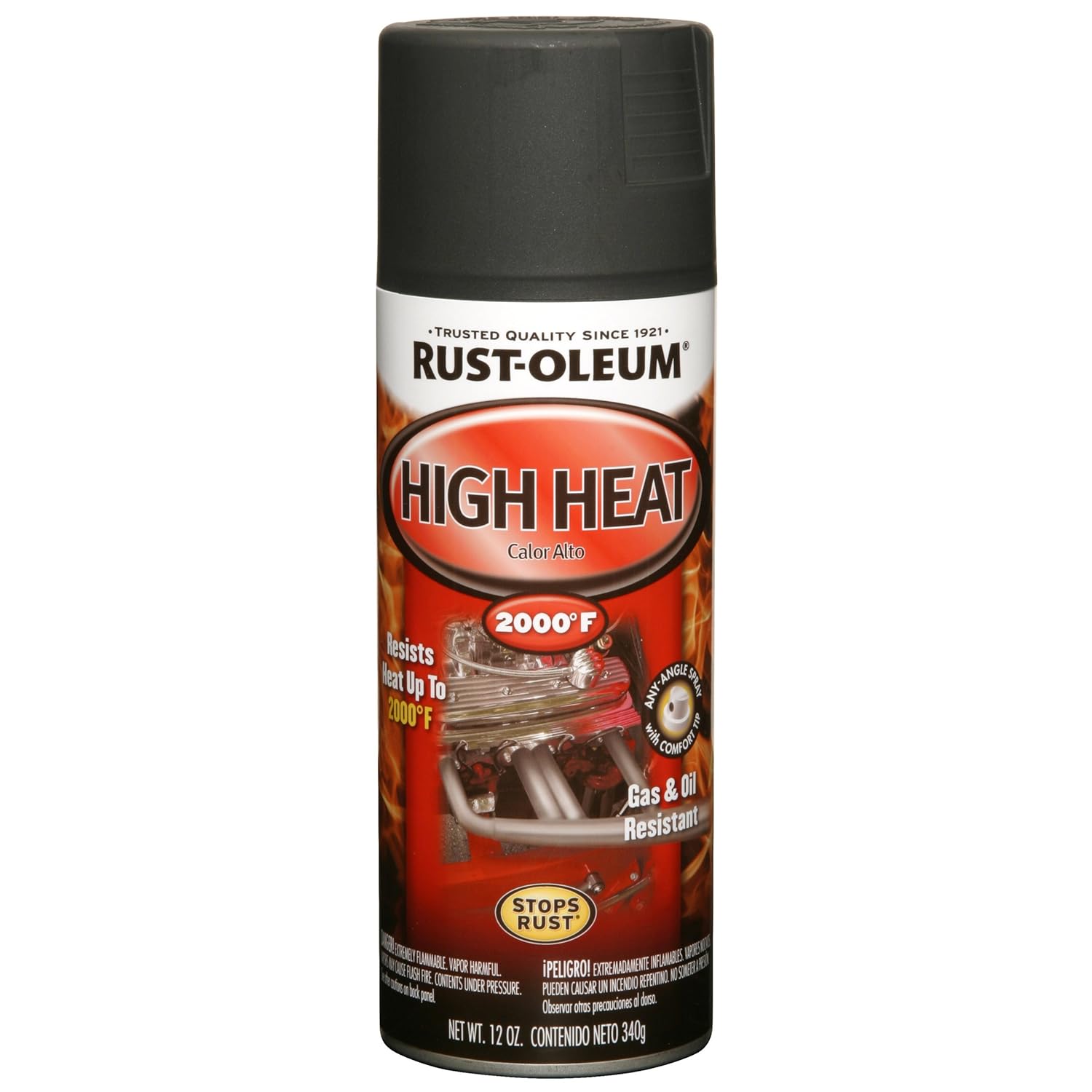

What kind of paint did you use for the header. It looks amazing. High temp spray paint?
biggie
Posts: 8302
Location: Clemmons, NC
Yeah, high temp (2000 degs). I'll have to go look to remember the brand. Dupont maybe.

94_240sx wrote:What kind of paint did you use for the header. It looks amazing. High temp spray paint?
The paint was Rustoleum.
