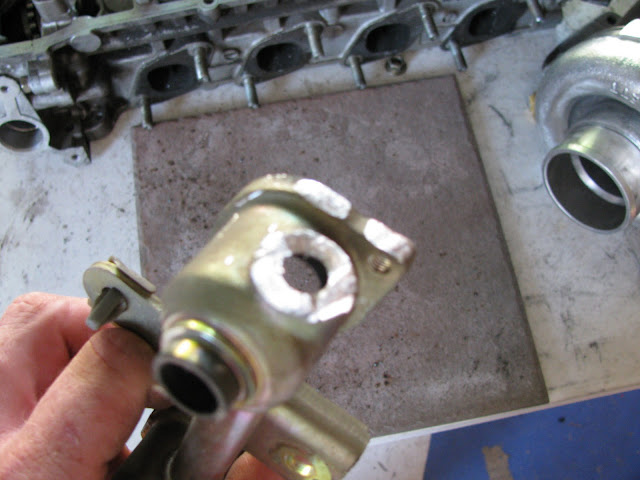

I finished the manifold up yesterday. It's not pretty but all I had was flux core wire since I ran of shielding gas. Also I wanted to mention that you shouldn't weld galvanized pipe, it releases toxic gases. I however had nothing else to use for the waste gate, so I was forced to use what I had on hand.
This JGS manifold has been beat up and rewelded 3 times now. The JGS manifold is a tank :yesnod

[quote="WDRacing"] Also I wanted to mention that you shouldn't weld galvanized pipe, it releases toxic gases. I however had nothing else to use for the waste gate, so I was forced to use what I had on hand.
/quote]
you know you can grind off the galvanized coating. looking very nice BTW

Yeah I didn't know that the first time I welded it...lol.
