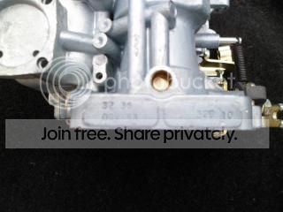

Check out my latest acquisition.
Image.
Better pics to come as I got a new camera. :dblthumb:

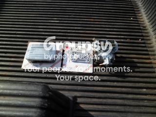

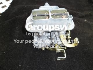

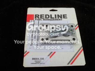

OK. I have some pics of the tank and the webber for installation. Here they are
High pressure system installed.
float installed.
Hoses installed.
Weber system and heres some more pics
As soon as I start the installation I post some more pics. I need to get linkage for the cable. :rotfl
