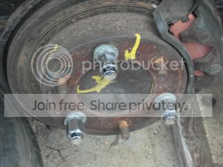

Also got the rear discs diff today. Need to change some lines and the disc pads then install. :rotfl

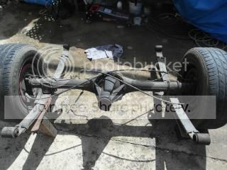

OK. The diffs bolted on with the new leafs and the drive shaft is machined to fit. Have to change some lines tomorrow and I'm considering putting back in the 5 fwd gearbox. The webber has also been installed but I want to test it without the MSD coil to see how much of a difference it makes. Didn't take pics as I finished in the dark. Pics tomorrow. :dblthumb:

Heres some pics.
Still have to install the drive shaft. All the shocks and bushings have been changed, the brakes are bled, the test drive comes as soon as I've installed the drive shaft. :yesnod

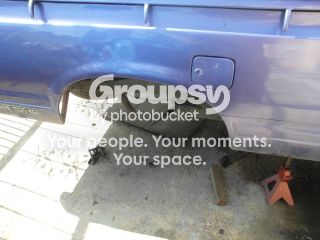

Have been working hard on the truck. Did not work on it today because I'm very tired. Here's the pics of whats done.
Thats the right corner, heres the left.
