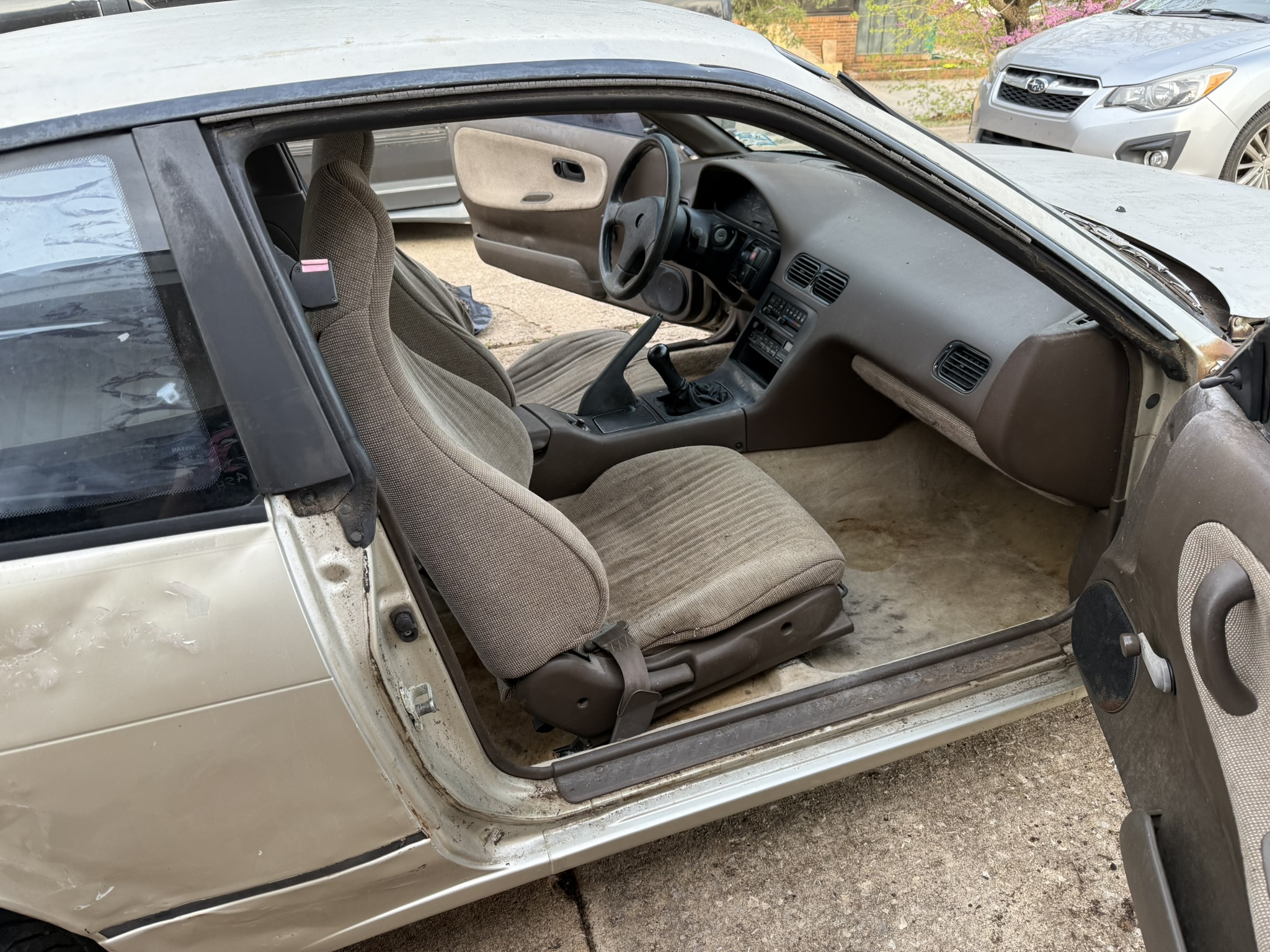

My daughter turns 16 in just over 18 months and we decided to pick up a base model 1992 coupe as a project to work on that will hopefully be her first car. The short version of the plan is to clean it up, replace all the rotted rubber and get it running again, hopefully for the RT66 JDM car show in Williams in October 2026.
We purchased the car and a U-Haul full of parts from a local friend for $1800. It looks like everything is there to complete the exterior of the car as far as any body panels I would need and Most of the interior is there (missing a back seat it seems).
While it has been sitting for about 10 years but doesn’t look like it will take a TON of work (relatively speaking) to get it on the road. The engine turns by hand easily, and when we hooked up a battery to it, most of the electrics seemed to kick on, so I am hoping that the only major harness damage is the spot I can see which seems to go to the headlights and maybe horn. The only current bad spot of corrosion I can find is in the spare tire well (some flaking) but most everything else seems to be surface rust. The engine appears to be completely stock (even has all of the emissions equipment hooked up).
The plan is to clean it up, replace all the rotted rubber and get it running again, hopefully for the RT66 JDM car show in Williams in October 2026.

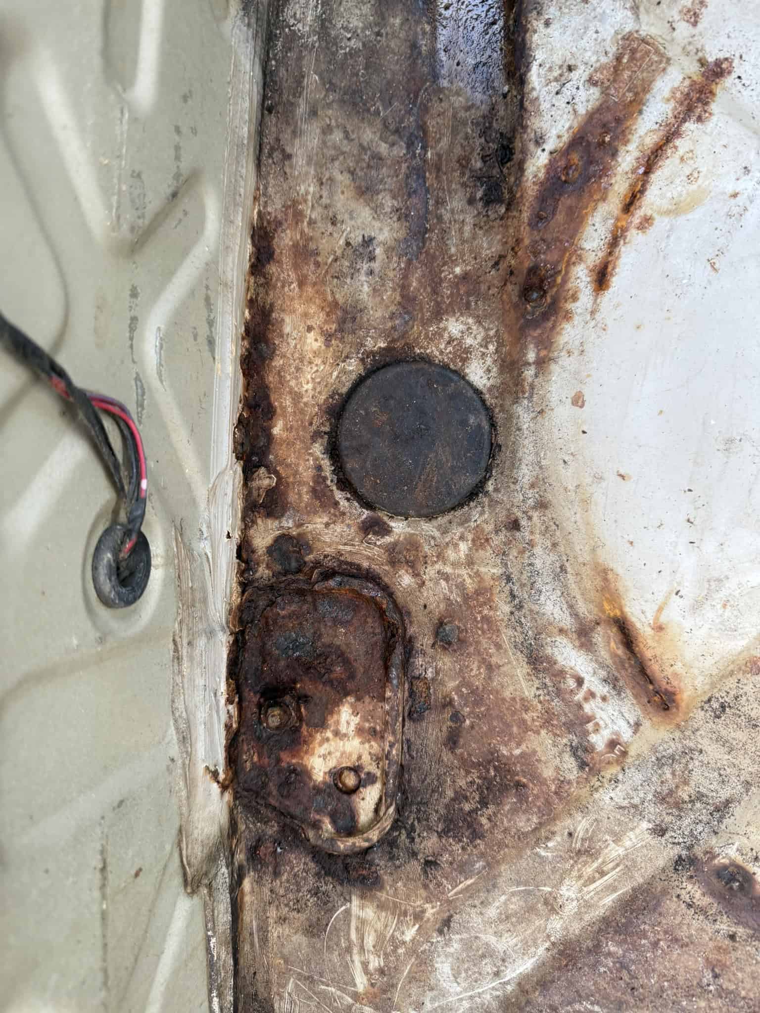

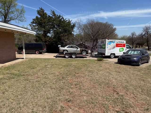

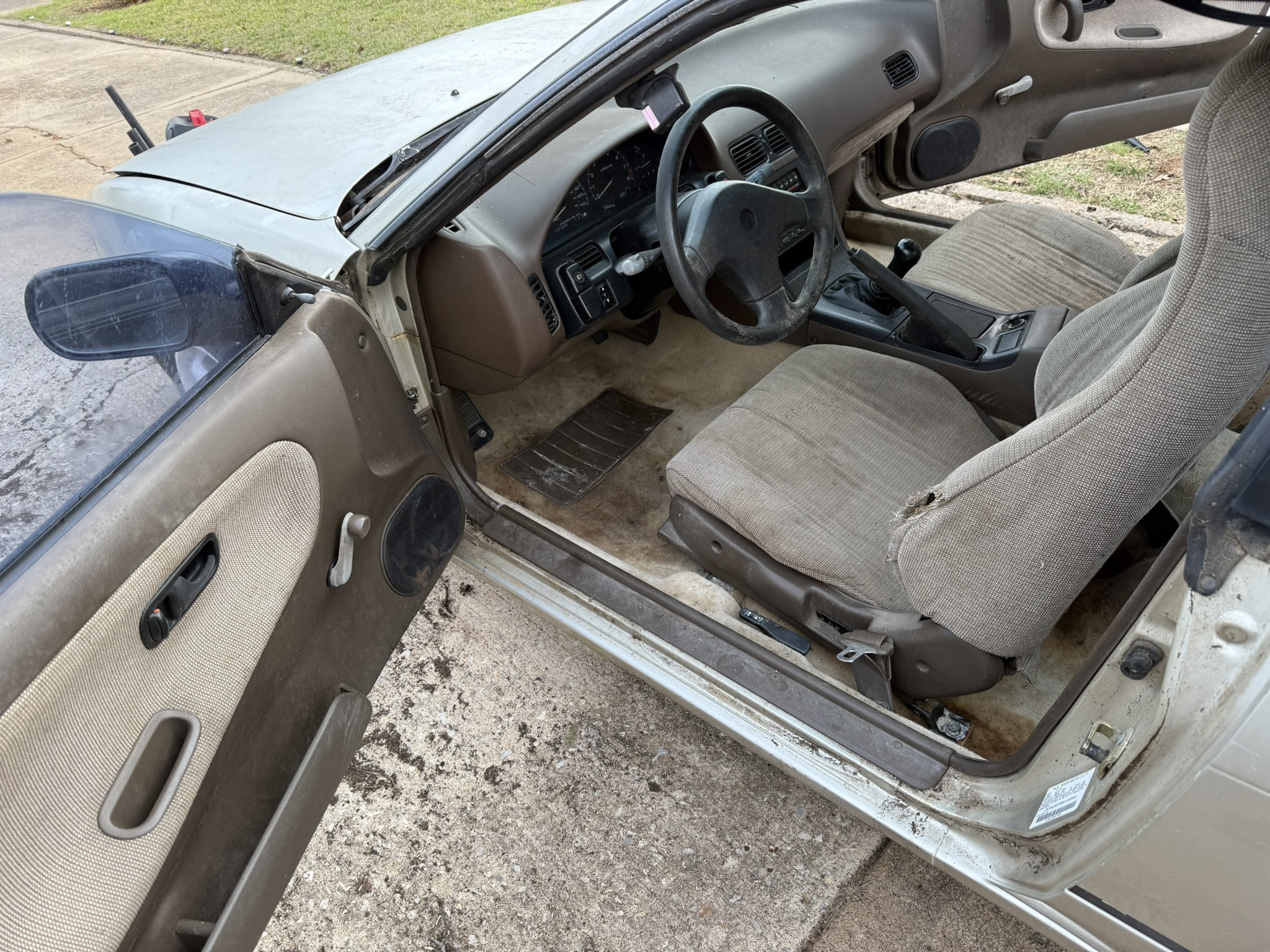

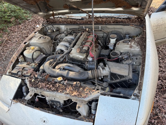

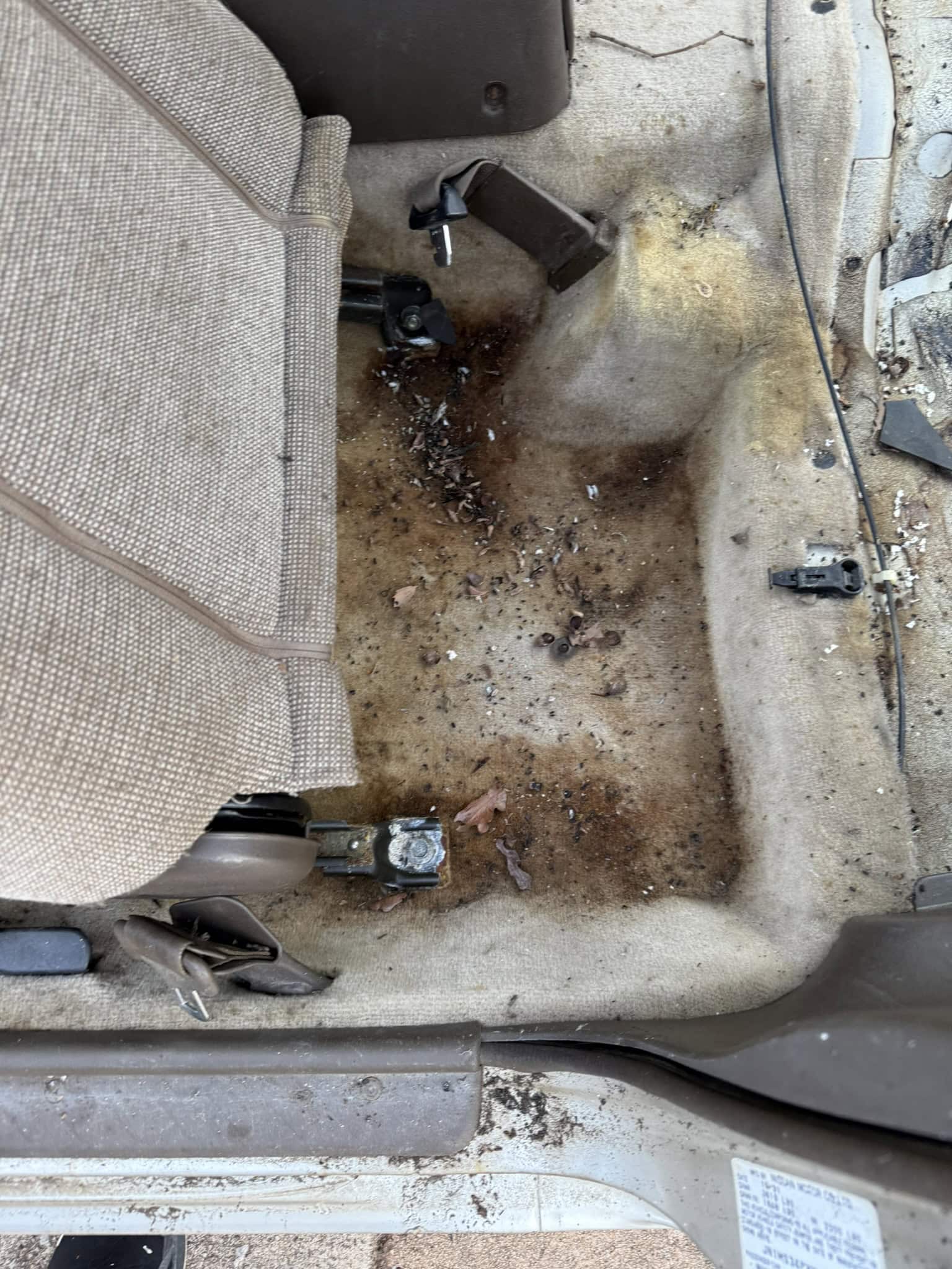

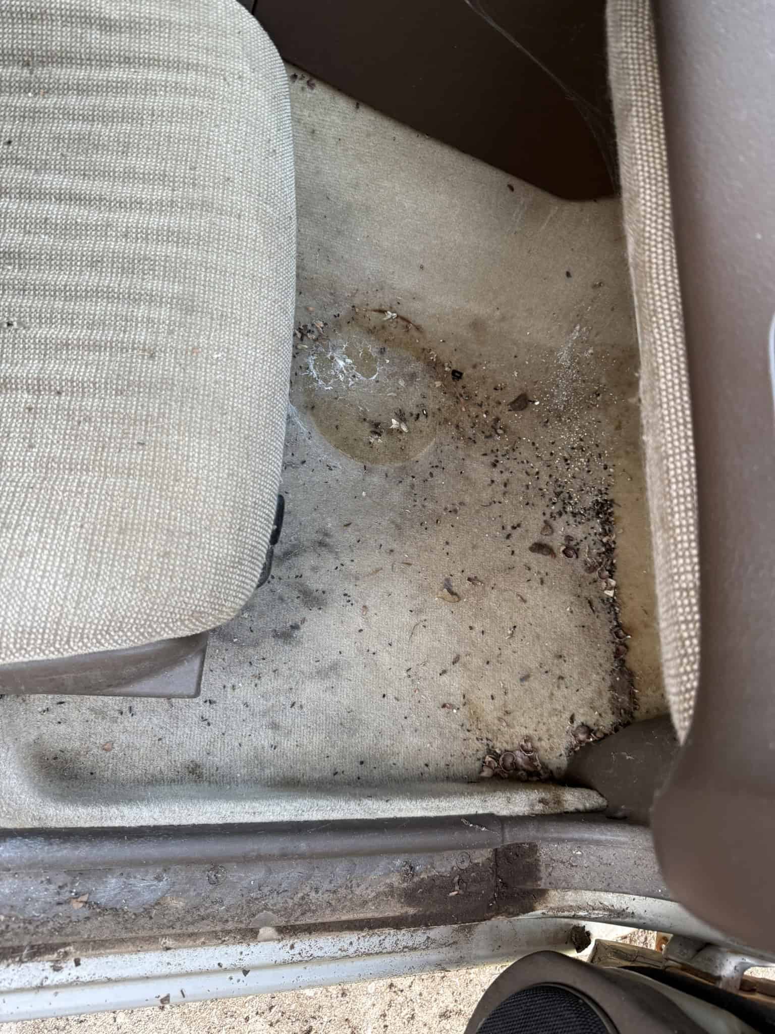

Photos:
Arriving at home

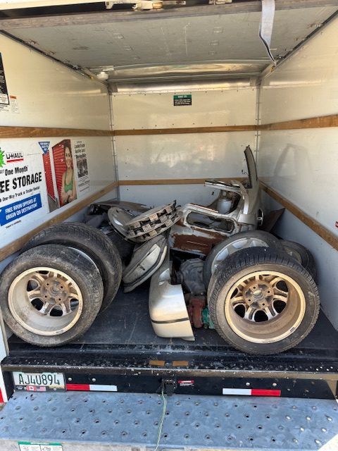

Engine bay before leaf and plant debris removal

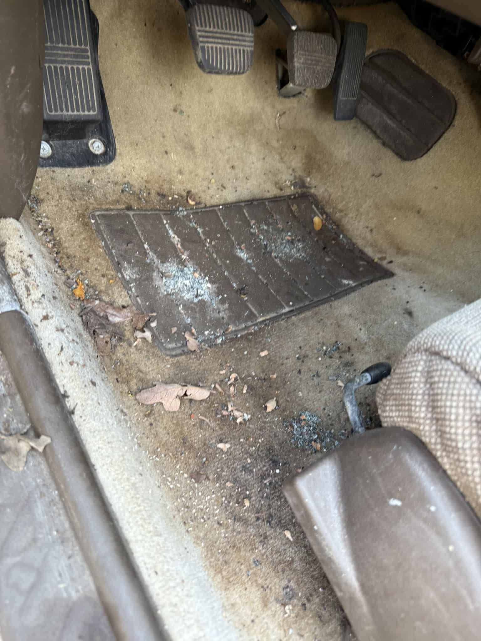

Mouse droppings
No Mouse Droppings

Patch of bad rust

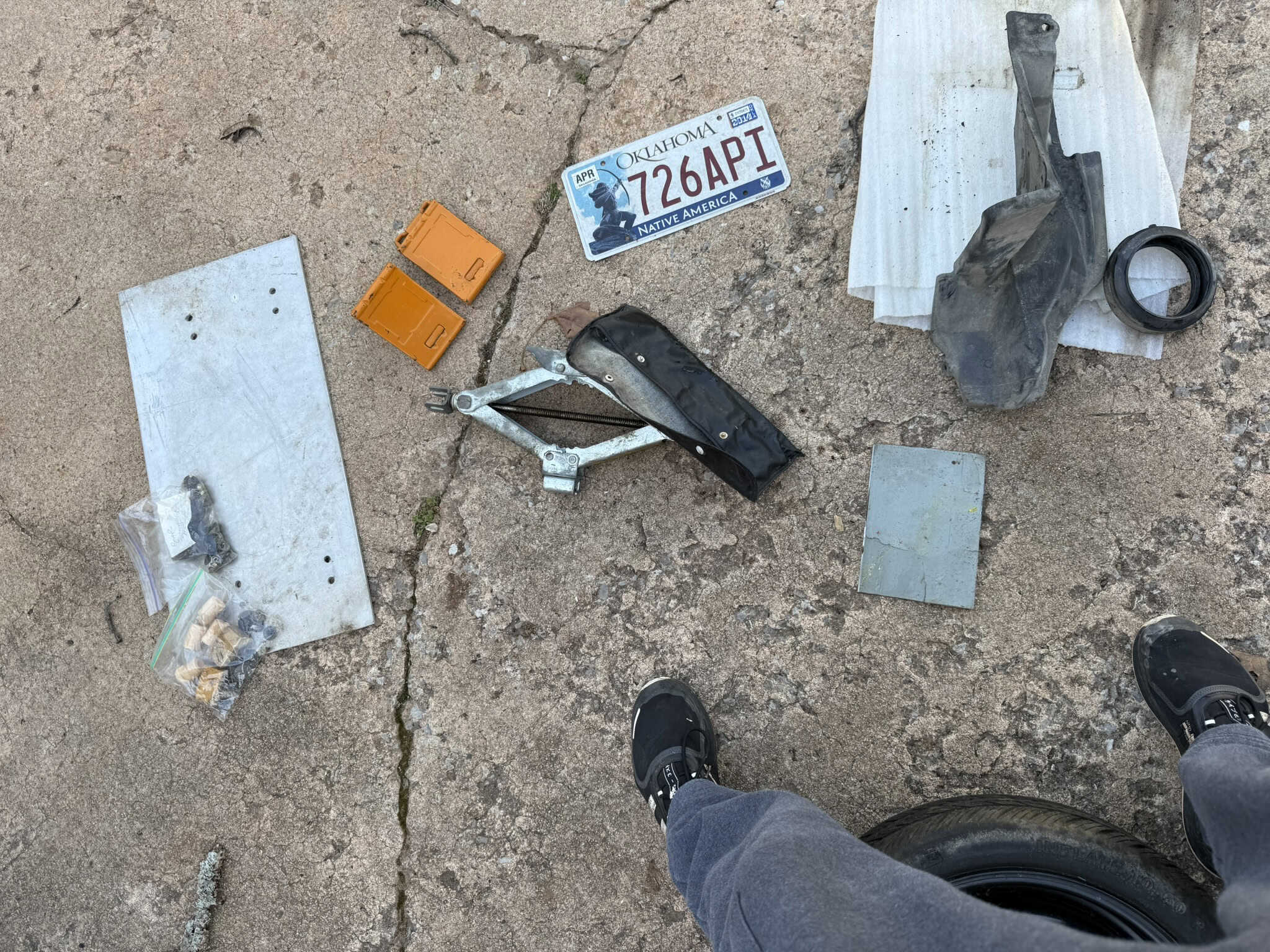

Still has what appears to be a complete OEM toolkit
