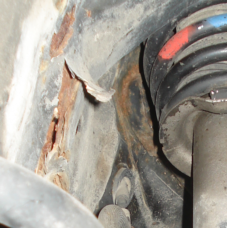

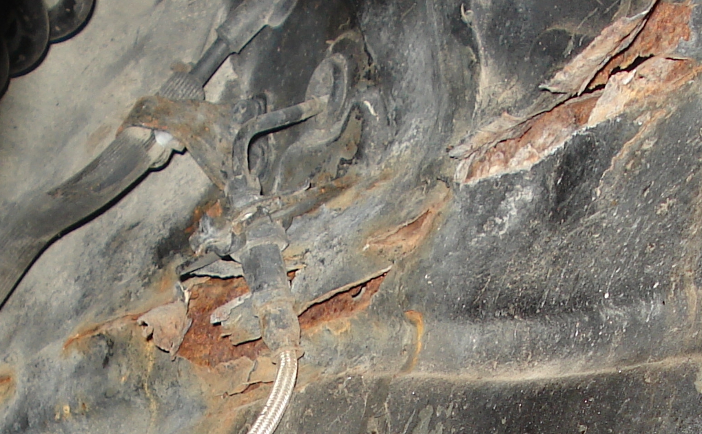

First glance (mostly 'obvious' stuff):
According to the serial #, that car was originally a Lightning Yellow GT-R V-spec. I don't see any evidence of yellow paint under the black, so I'd be looking REAL close for some welding evidence.
Brake lines along firewall aren't in their original configuration, so that concerns me too - front clip replacement?
Paint (looks to be a respray, and not a good one), bad weatherstrip, rear package shelf (looks like water damage from bad weatherstrip), front lip is shagged, corrosion at the CAS, brittle coil connectors, lots of janky s*** under the hood.
That motor's been out (more than once, likely), so I'd check the serial # and see if it matches.
Grease (or brake fluid) at the front spindle - Bad ball joints or drive axles... wait - where the hell are the front drive axles????
WTF did they do to those front tires? Looking further, it looks like a front tension rod snapped, sending the tire / wheel backwards into the fender - that's ugly, and could have been a sad ending. That would explain the gouged / shredded tire tread, and bits of rubber flung up into the wheelwell.
My biggest concern is the corrosion - It's bad. Not just bad, but possibly "parts car" status.
Rust (inner and outer rear wheelwells, with evidence of a really poor repair, rust in the trunk lid, filler neck, front AND rear strut towers (this is a critical area of structural integrity), battery tray, tension rod mounting surface.
I hope you didn't spend a lot on her - I'd be afraid to drive it without some serious unibody repair. Problem is, you live in a climate almost as bad as where the car came from, so the rust isn't going to stop.
These two areas are a HUGE concern:

My fear is this - From the looks of the fenderwells, along that main seam (where the brake line is falling away), AND up inside the strut towers, that's all structural.
A proper fix will mean gutting the car - stripped to the shell. I think once a shop starts poking into those rusted areas, they're going to find more. The rear fender bodywork is actually the least of your concerns. Paying someone to weld in new metal (while keeping the car square and true) is not going to be cheap.
I'm seeing $10k *minimum* in structural work / rust repair / bodywork / seam sealing / rustproofing / paint. You could wind up with a $20k total restoration bill (even doing some of the work yourself).
If it were mine, I'd either try to flip it to someone who doesn't care about condition, OR sell it as a running drivetrain for an S-chassis swap (and then sell the front bodywork for a conversion). Seats, brakes, dash, differential, and some other goodies all sell pretty well, and should get your investment back.
