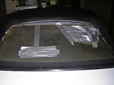

The back windows on these cars are usually bad. This is a good condition rear window of a 240sx convertible.
Here is a picture of a bad one. (mine )
I cant even see through my back window, I have to reverse with the top down haha! The windows are a pain to change by yourself. If you take it to a shop, you should expect to pay around $250 - $300 incl. parts to get it changed.

1. Back window condition
I cant even see through my back window, I have to reverse with the top down haha! The windows are a pain to change by yourself. If you take it to a shop, you should expect to pay around $600 incl. parts to get it changed.

Actually the window on the "good" one is a little foggy, but you can still see through it.

-Feel free to use my car as an example of a REALLY bad window:
