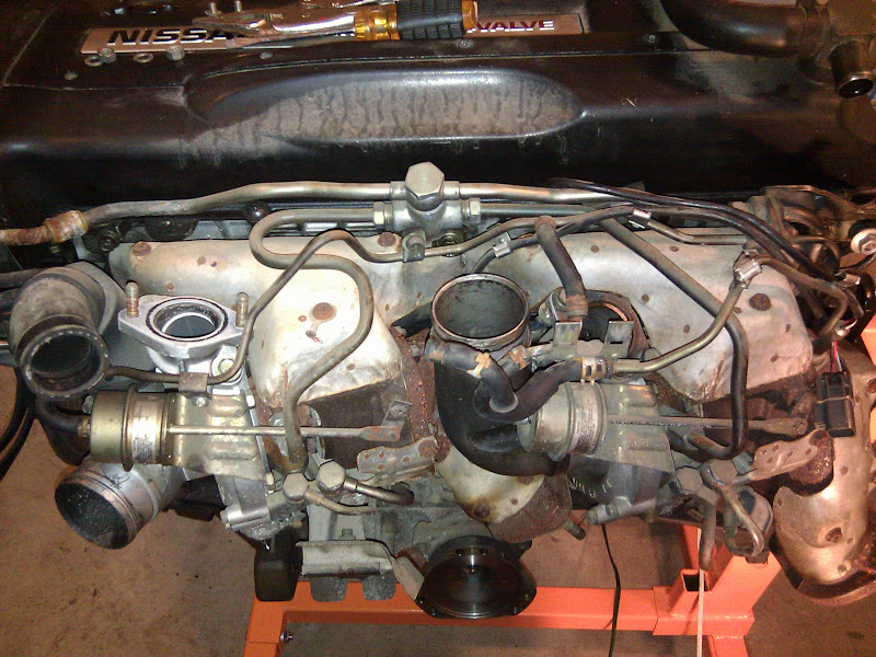

So here we have the clip on the day it arrived. It looks like a mystery doesn't it? 91' BNR32 Clip purchased from JDM Planet on ebay as a side deal. I purchased it because of the attractive price and the condition of how everything looked in the pictures. It came with all body panels, head/tail/corner lights, interior dash etc, engine ecu, attesa ecu, some other ecu looking box, brakes, suspension, and other misc stuff. I also got the entire rear subframe minus the rear rotors and calipers.
A glimse under the hood before tearing it apart.
The interior, night shot.
A shot of the VIN plate and chassis code.
The growing parts pile.
Starting to pull the motor. This one is dubbed the "Iron Man".
Motor out.
Other motor out. Dubbed the "Hulk". Yes, that's a Z32TT gear box.
Ok this thing is heavy. It bent my engine stand lol. Time to tear it down.
Almost bare block.
Very clean piston bottoms.
Full bottom end laid out on my tool box.
When I have time, I need to get the block, crank, head, crank pulley, clutch and new internals/bearings over to the machine shop for decking/mill, bore, and install collar + balance + polish crank. The other leg of the project, I still need to go get some Argon/CO2 gas and make a big 220v extension cord for my welder. I also need to pick up some flat bar and other various steel things to begin the chassis mods. The front axles need to go to a local axle rebuilder for some freshening up. I'm sure there's more things, but I go blank all the time.
