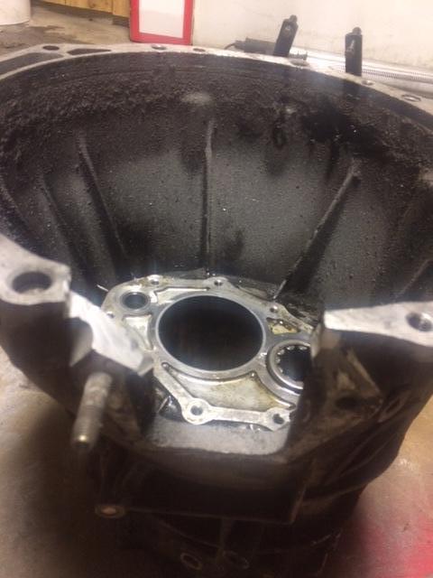

Managed to mate the bell housing to the engine, with a couple of small cuts with the deathwheel. will be putting the trans back together soon, and slightly enlarge the mount holes on the trans.
will have to make a dust cover for the z32 starter hole/ over the vh starter.

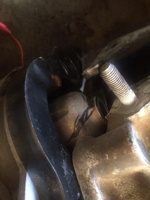

I went with using the stock starter. It takes a bit of work, but you can avoid cutting into the block. The adapter plate, flywheel and bellhousing aren't so lucky.
My approach
