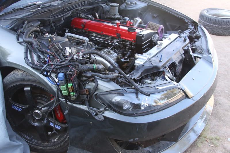

sci2000tech
Posts: 570
Joined: Mon Jan 31, 2005 3:24 pm
Car: '92 Nissan 240SX S13.5 RB20DET 'Vert
I hear ya.
At about this point, I said F it, may as well do a full tuck and fix everything.

sci2000tech wrote:I hear ya.
That's a good looking car you've got there. You would benifit from getting all those wires out of that nice engine bay :chuckle:

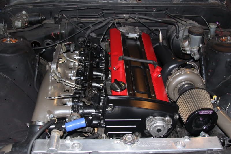

Thanks man.
I would take you up on your offer, but I already got my tuck done :naughty:
I just finished up the engine harness today, so there are a few more wires than in this pic but you get the idea.
I paid a bit more then what you're asking too and have seen people pay $500+, so I'd say your price is more than fair. Since I had my tuck done at Ace up motorsports, they have probably done wiring on at least half a dozen other cars. I think the demand is there when the price is reasonable.
OK, I'm done thread jacking with my pics now :gapteeth:

That looks awesome! Well i'm glad you got it done. Keep up the good work :dblthumb:
