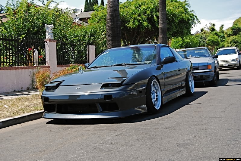

Yeah, I think you need a minimum of +18 to fit a 10 inch wide wheel. Here's a profile of a guy running 17x10+18 up front with stock fenders:
http://www.rimtuck.com/setup.php?id=755
As you might notice, the owner listed using a spacer in the rear, but not in the front. This puzzles me, quite frankly. Because some other ppl say that a 9.5 won't even fit unless your offset is like around +12.
Here's 18x10.5+15 with 3mm spacers making a +12 offset and I think 235/35 tires all around:
I hope this helps.

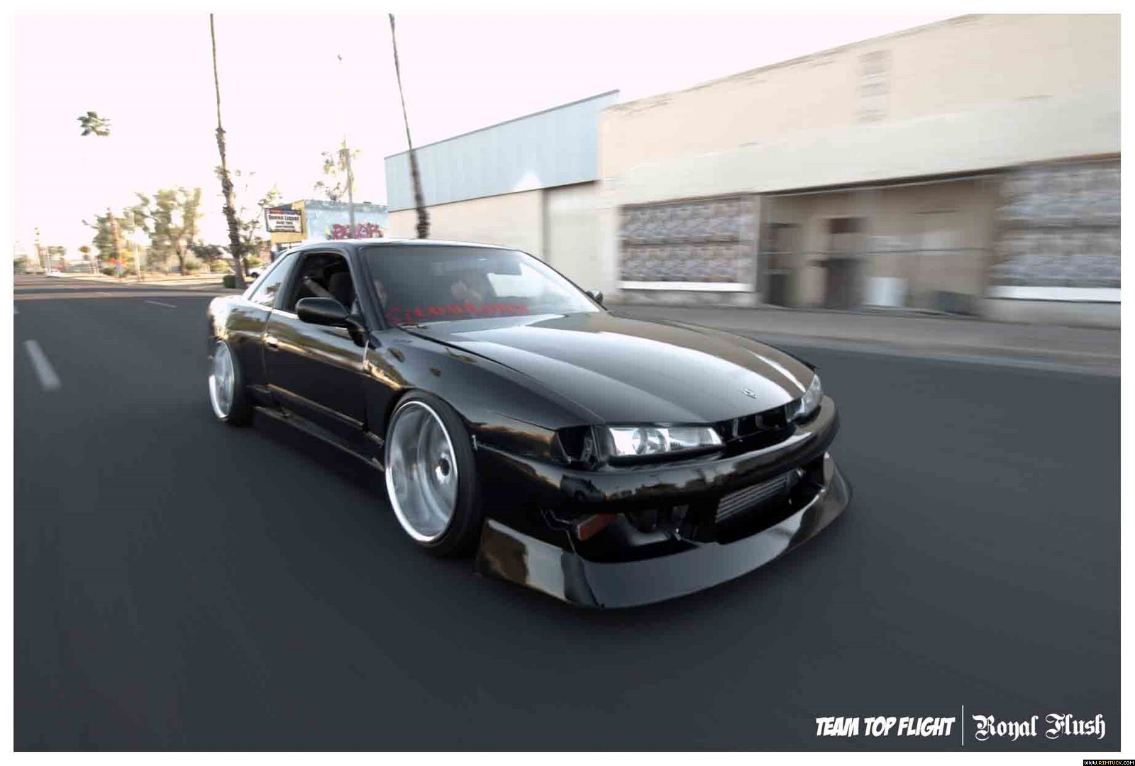

this guy is running 10J -34 up front on modified stock fenders. stay metal f*** fiberglass.

you gotta remember
those are s14 Kouki fenders up front on that coupe.
He has more room to play as the s14 fenders allow more space.
