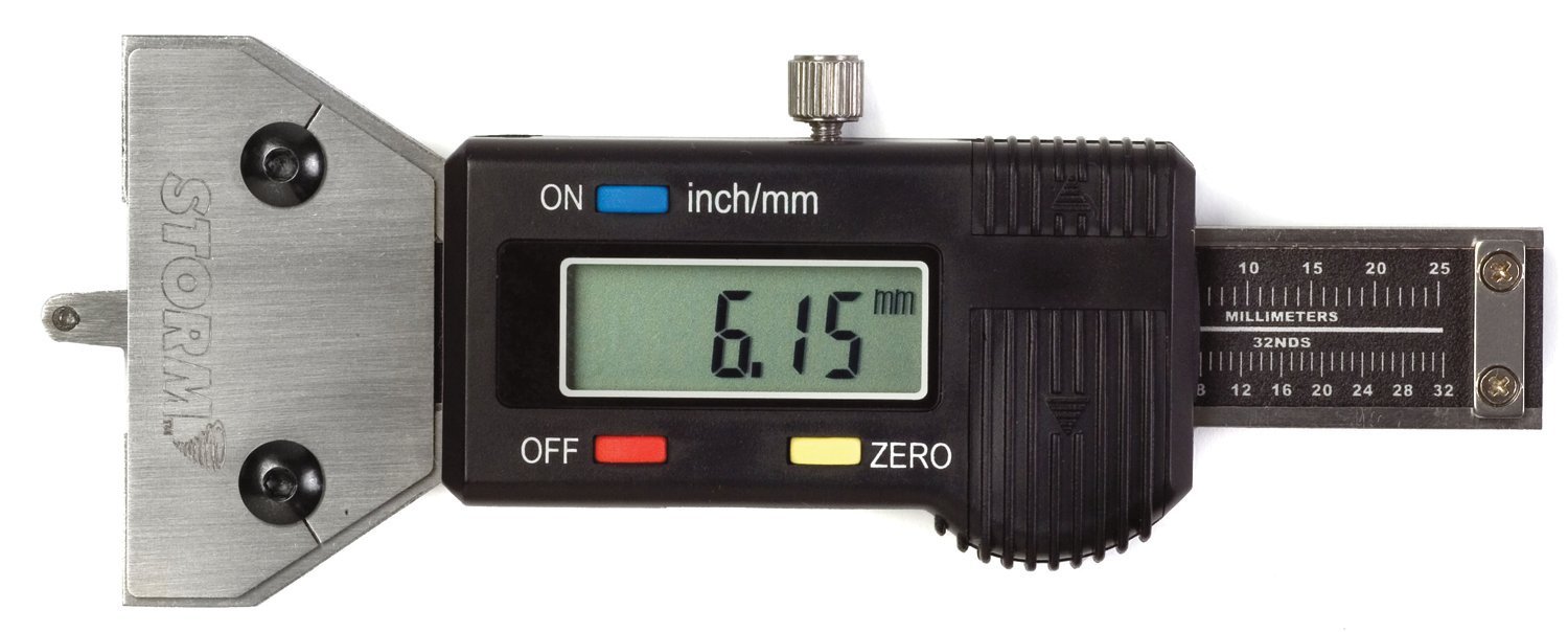

I is a lot finickier! :gapteeth: :chuckle: Here is what I have and love: http://www.amazon.com/gp/product/B0015D ... detailpage
It measures in 32nds too, not just the millimeters shown. And $19 is not too expensive at all. Provides excellent accuracy to see how the tread is wearing across the width.
Regardless, a cheap pencil depth gauge should be mandatory for all of us ... before I got this fancy gauge, I simply kept one of those pencil depth gauges in all my glove boxes ... they are inexpensive enough and we should check our tires periodically to see how they are wearing across the tread width and adjust tire pressure up or down accordingly (but never going below 33psi for our cars!). :yesnod
