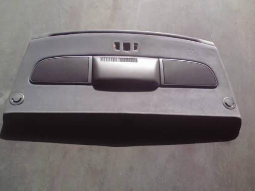

elwesso
Posts: 30810
Car: 94 Infiniti Q45t 5 spd
2007 BMW M Coupe
2007 Infiniti G35 S 6MT
Location: Indiana
nissan presidents had a rear evaporator where the package shelf is on US G50s.
qship96
Posts: 6624
Car: 1996 Infiniti Q45
elwesso wrote:nissan presidents had a rear evaporator where the package shelf is on US G50s.
I thought that was just an "air cleaner" electrostatic /mechanical filter element?
Infinitiguy19
Posts: 7787
Joined: Sat Dec 22, 2007 4:58 pm
Car: 1993 Infiniti Q45 188580 Miles
1994 Infiniti Q45a 240000 Miles
http://picasaweb.google.com/lh/photo/ig ... directlink
:couch
qship96 wrote:some cars, like the Audi a8, lex LS ,and even really old {1960s} cadillac/lincoln offered true rear a/c that was independent from front a/c- there is a second evaporator in rear trunk that blows cold air to rear seat passangers.....much more effective than just putting vents in rear console like later Q cars
With all the things I want to do (Including hit the lottery) I would think importing a Nissan President would be the best thing to do. The Nissan President had rear air vents but no duel heater core of evaporator.
Give me a Nissan President (1989-2001), 100K worth of tools, a shop with a lift (Should be included in the 100K worth of tools but I am stating it so people can know) and I will give you the best Q45 in the world! No promises on the time to completion but I would'nt leave the shop till its done. :biggrin: Hell I might do it for free knowing I could drive the car because I love working on Q45's.
Dreams...
