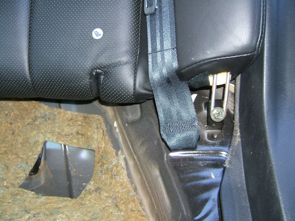

    Mine has this module installed and the connection is under the rear seat. I have to do my trunk struts in the next few months and will grab a pic if needed.

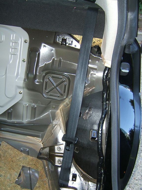

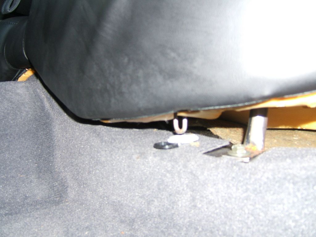

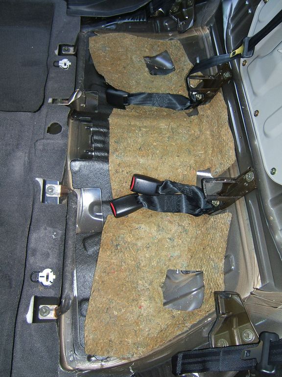

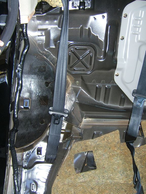

    Nope, it wasn't under the seat. I know because I took it all out to look.
    1) two screws behind armrest
    2) two slide clips and the lower seat comes right out.
    3) two more screws and the back rest comes right out.
    4) Nope, no wires here.
    So, I put it all back in and looked in the trunk once again.

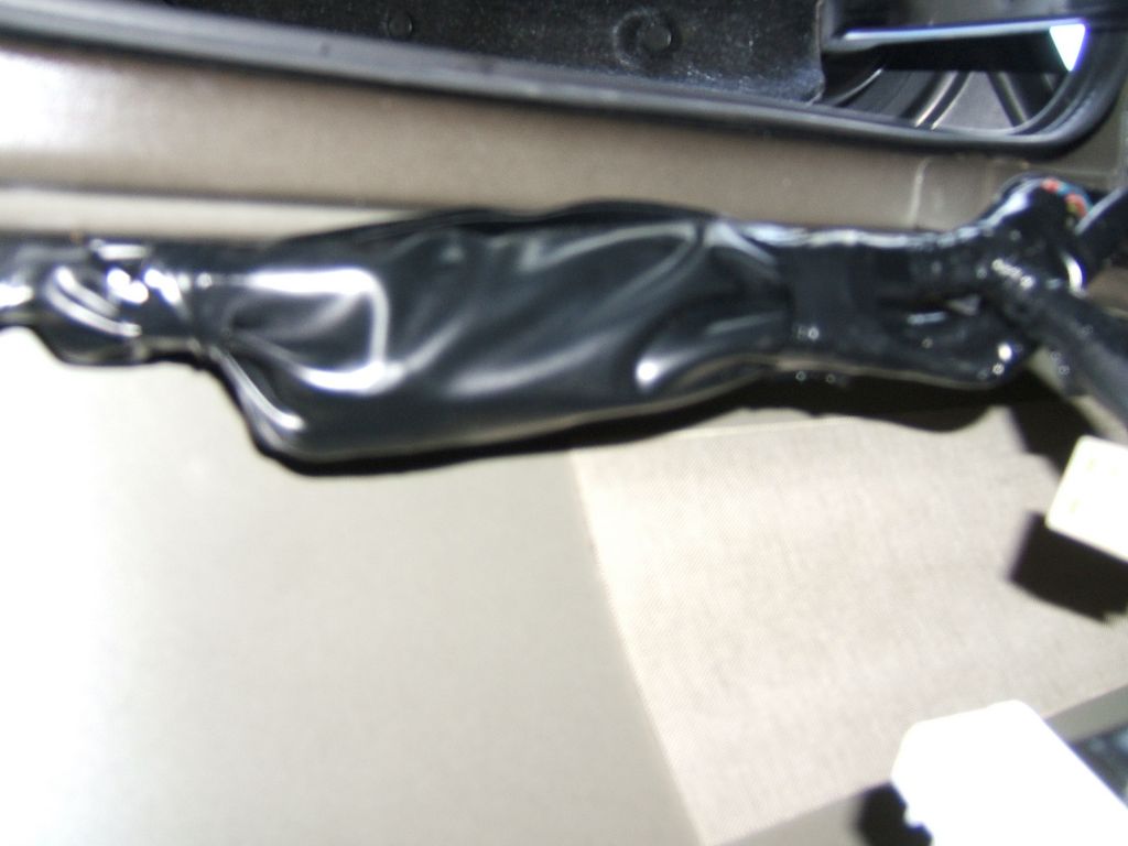

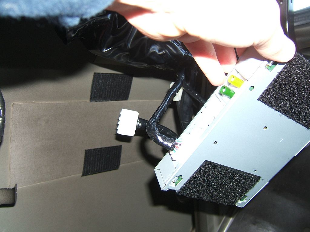

    1) finally found this weird hunk of wires in the left fender well
    2) unwrapped and saw a connector dongle attached to two males
    3) connected directly into the receiver
    4) attached Velcro and attached to inner fender (stupid, should have put on metal brace just to the right)
    5) used the antenna's supplied template to place on roof.
    6) easily pushed back the rubber seal lip to hide wire and fish around to the trunk.

    Interesting...Mine is under the rear seat but is wired in the seal like yours instructs. Be sure to get the wire in there good as mine tends to sneak out occasionally.
