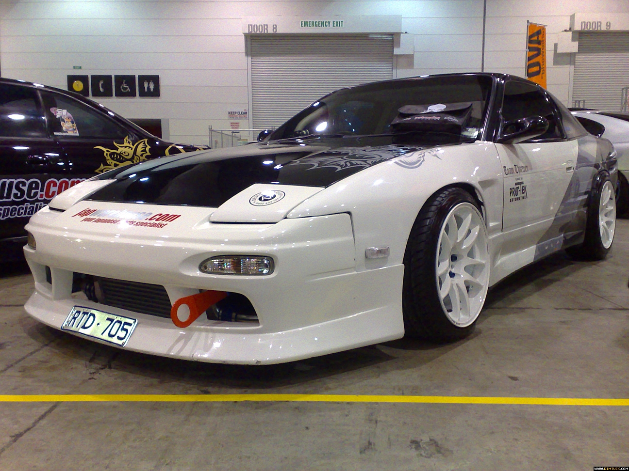

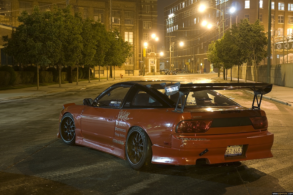

crash n burn wrote:rota p45r..probably a 17x9 +12.
Thats what I was thinking, but I'm at work and can't see any pics cuz the server blocks 'em. Folkerts, if you go with 30mm spacers, that'll effectively make you 17x9-18. Seems really excessive to me.
Here's the closest I could find on Rimtuck. Your fronts would poke out 5mm more than this:
http://www.rimtuck.com/setup.php?id=336
Rears would poke out 3mm more than this:
http://www.rimtuck.com/setup.php?id=423
If you're going for the "Zilvia fitment whore/I wanna be on Hellaflush.com" look, go for it, I guess... :gotme

crash n burn wrote:rota p45r..probably a 17x9 +12. if you'd gotten the 17x9.5+15, you wouldn't be having this problem..they fit perfect..but that's with a stock body..you have over fenders don't you?
yea i have overfenders. 20mm in the front and 30mm in the back. i believe those are the sizes. the last owner put them on so im not sure
as for the first picture im not putting spacers in the front.
and in the second picture arent those stock fenders. i have 30mm overfenders in the back
and yes i do want to be in the zilvia fitment whore thread. haha. i was scrolling through there looking for ideas.

I think those are 50 mm spacers in the back of d*star's car. i.e. 17x9 -15 effectively

yeah they're 17x9+12 if you want to be in that thread..i mean idk how much shooting to be in a thread should effect your decision, you should grab some 40mm spacers/make them..however and camber/toe the wheels to fit. keep the 225s..they have a decent stretch..no need for rubber band tires
