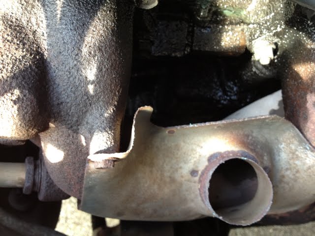

1. As for the EGR valve and its buddy, I’ve deleted the vacuum hoses that were coming from the carb and plugged the two remaining ones on the valves themselves (pic below). Do I need to remove these valves and find a way to plug the manifold, or are the harmless in their current state?

4. I haven't blocked off the old EGR tubes that were coming off the exhaust manifold, and I don't intend to run it excessively until I do, but I did notice quite a lot of smoke coming out of the larger one this morning. Would you think this to be normal, or evidence of something really bad.

The EGR valves may be necessary for your emissions inspection. However, connecting the vacuum to the carb with the screw still in the vacuum port with prevent them from opening. I dyno'd a 7 hp gain at the rear wheels with the EGR blocked AND lower HC results. It makes no sense to me to inject essentially oxygen less air into something that needs to be burnt.
Pull the darn heat shield off of your exhaust!! It looks bad. Where the old vacuum things are in the manifold and no longer used, get some pipe plugs. I also noticed your air filter is white, If its the gauze unit put some K&N oil on it.
