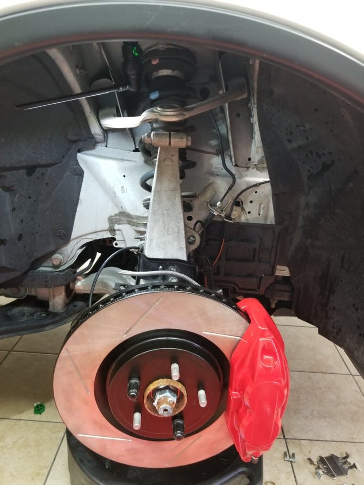

Old lines work, all you need new banjo bolt and cut rear dust shield.
Keep in mind frond brakes are huge, so there will be clearance issue with factory wheels. Spacers is needed, or new wheels.

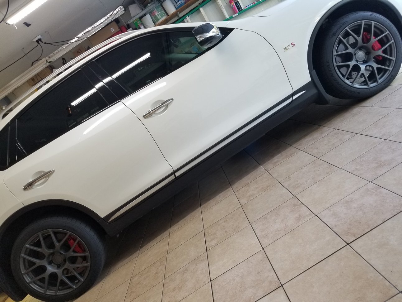

Would they clear the 19" wheels?
Would you mind laying out what exactly you did to do what you did? I have a 2017 qx50, and I feel like the brakes are nowhere near good enough. Mine have already started warping
Like I said, front factory 19" wheels will need spacers, rears are fine, I have changed front and rear brake lines with stainless steel ones, this step is not necessary, but if you will opt out, new (shorter)banjo bolts needs to be changed.
Rear brakes shields needs to be trimmed.
