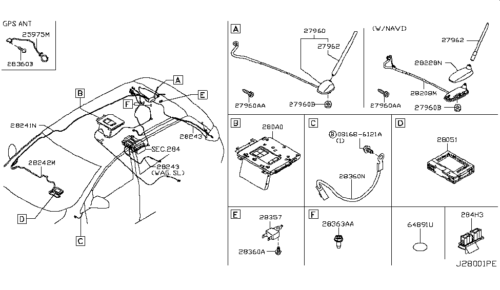

Hi, new to the forum so please be patient with my dumb questions. I have owned a 2011 Nissan Murano LE for 4 years. Love the car and have done quite a few factory upgrades myself to get the car to my liking. The only thing that it doesn't have yet is the factory Navigation. I am taking a shot in the dark here hoping that I can do it as long as I have all of the factory parts which I think I do. Over the past year I have been picking and choosing all of the parts, i.e. Bose head unit with nav, (already have a bose system in the car), nav color screen, heater/ac control panel, nav control panel, and nav antenna. Now my next question is will this just plug and play or will I have to get a special wiring harness to complete the upgrade? I don't mind doing the work and I have spent a lot of time already upgrading my Murano, I just want to do it correctly and not Jerry rig anything. I know I am in deep already without having the correct information but like I said, it was a shot in the dark hoping I can do this. Thanks for your time and look forward to any help I can get!!

A: Technically yes, BUT it will not be cheap or easy. Currently used Murano NAV units are selling on eBay for about $570 USD. Those units will still need additional equipment to operate, costing even more money. Not to mention that there are no current maps as they were discontinued several years ago.
