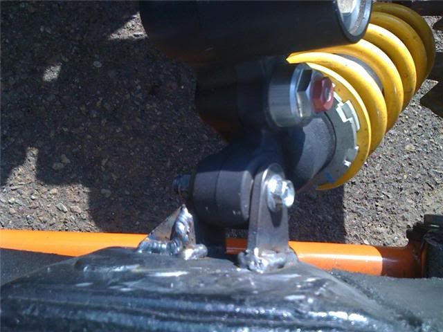

Your coilovers are on a hell on an angle, how does that affect the progression rate? How much travel does the rear end have? Nice work, man!

and the rear is pretty firm id say about 2 inches of travel if i really mash a bump.

looks good except for the rear fender.
I thought the shocks were supposed to mounted as vertical as possible? From the pic it looks like the upper shock mounts just have a tack at each end of the bracket. You might want to go in and add a little more gusseting and welding to make them more secure. The shock mounts take a lot of abuse, especially if you are going to keep autocrossing that thing. (that was you right?)

and as for the uppers its just the pic heres another.
and i got a few peoples opinions and was told the angle of the shock would add a progressive spring rate? it seems to ride really good, kinda feels like how my buddy's s13 w/ coilovers feels like.
