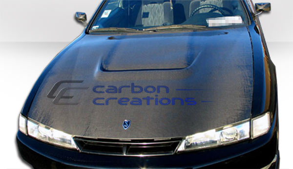

And I don't know EGTs because I haven't purchased my gauges yet. But under the hood could cook your face. I plan on wrapping the stock mani, dp, and getting a turbo blanket. And I also plan on cutting up my hood and venting it via...Image

Sure I would love to see pics of your set up. My engine doesn't over heat but I am just looking to lower underhood temps drastically because it is heatsoaking EVERYTHING. I'm going to try all the stuff I stated before and the hood scoops. If all that doesn't help, I will change out to the Carbon Creations M1 hood...

I have a vented hood on my S14. Great for letting the hot air out.
Bad part is OMG my engine bay gets dirty really fast!. My car stays at my friends shop in the desert and the engine bay looks like it.
