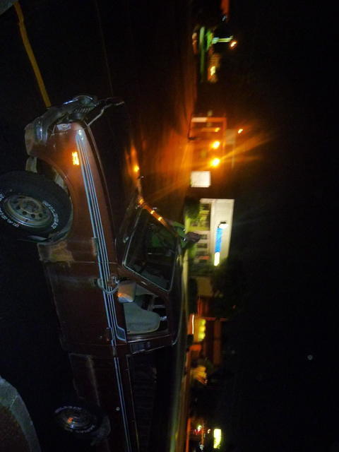

We initially broke down near Spokane's red light district. Fortunately, my friend was able to push it a few feet (away from the homeless guy sleeping on the grass next to us) and I managed to get it into gear and go south a mile where it was much safer.
