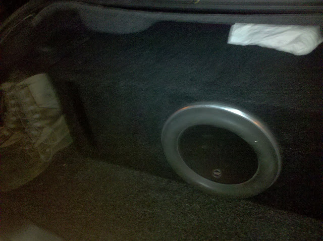

Well Fixed the problem. But I dont know how haha. Picked up my box for my sub today and installed it all. Disconected negative and reconnected. Driving Home and looked at my dash to see no light :biggrin:
That made me happy.
anyways i put a jl audio 10w7 in the trunk and it slamsss. puching about 800 watts to it in a ported box
