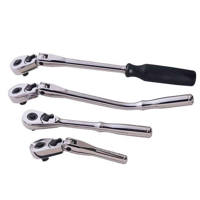

The plugs in the G are pretty easy you need a few extensions, a flex adapter, 10mm, an 8mm (for the intake). I would also suggest something like this.
http://community.craftsman.com/Craftsma ... ab=details
