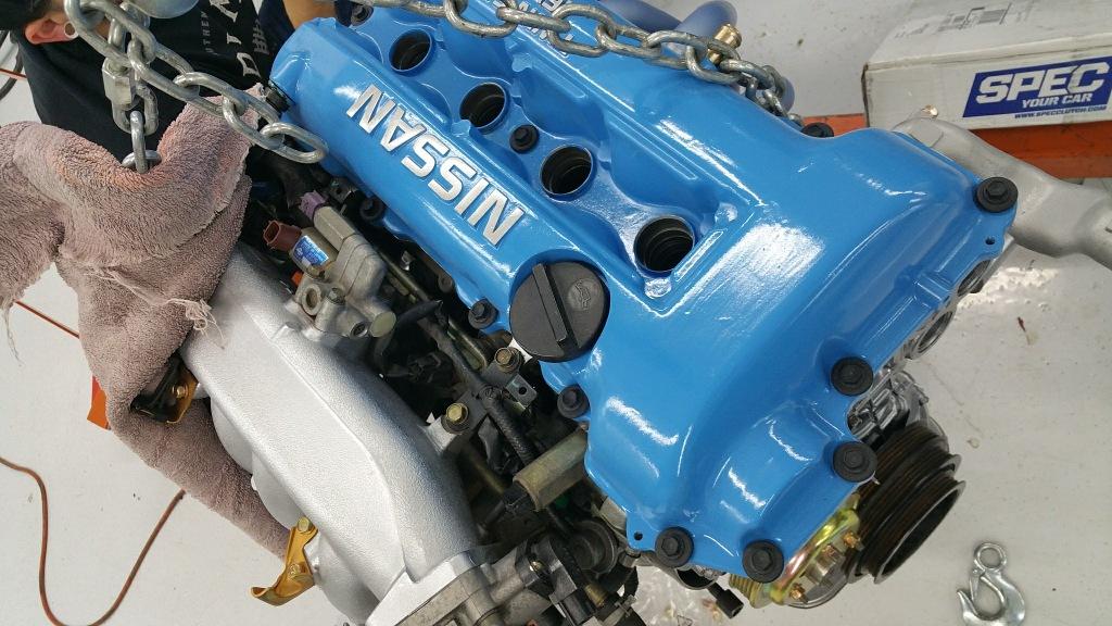

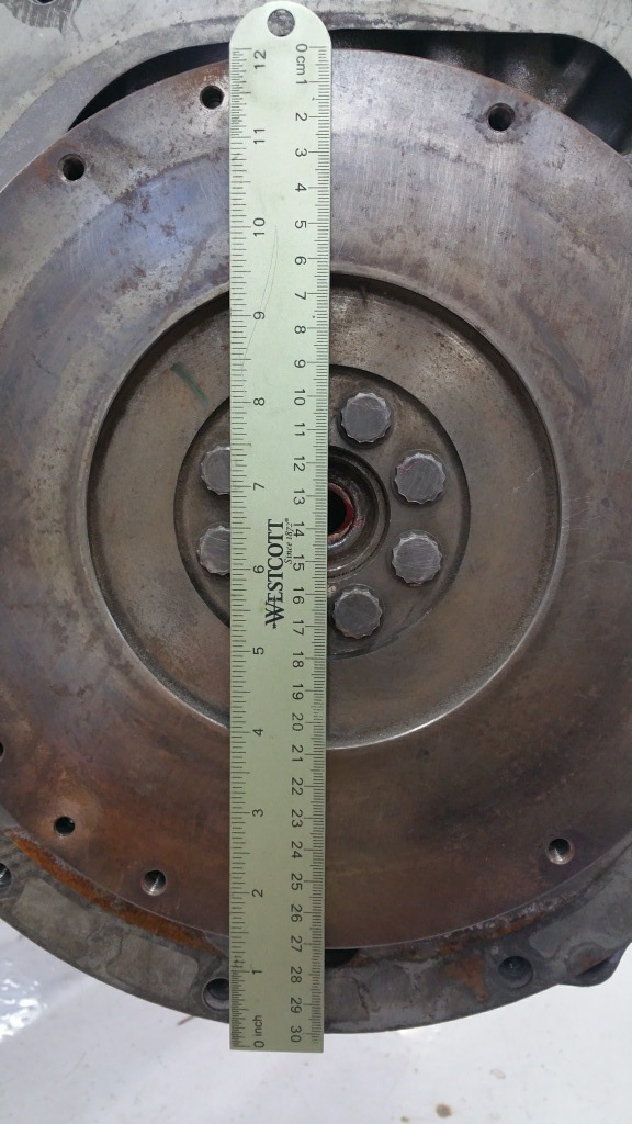

I have here what I *thought* was an S15 SR (N/A). I ordered a clutch for it, and found that it's not the correct fit - the bolt holes don't line up.
Flywheel is 275mm.
Any idea what I have here, guys? I need to order the correct clutch. :(

It may be an S14 N/A SR. I know S15s have a different clutch than the rest of the SRs.

Alan (nismo_freak) sent me some help as well, based off the codes on the block and head. Looks like its an early S15 Spec-S, with maybe a carryover (or replacement) flywheel.
