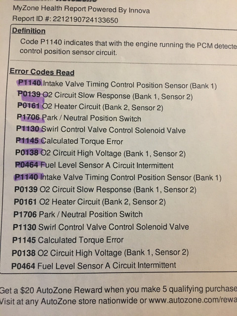

ok, so I took the washer fluid LED and soldered onto the SES location, which now illuminates properly. Took to get codes read at autozone, and whola .... a long list of fun stuff to tackle. I wouldn't even know where to begin, and notice some codes are duplicates or run together.
Any suggestions on where to start? I must get this vehicle to pass smog inspection in Nevada...

Look in the FSM in the EC section, it will help you a lot with troubleshooting the error codes. The FSM lists all the error codes and the description and troubleshooting steps.
https://nicoclub.com/FSM/Pathfinder/2001/ec.pdf
I would suggest you purchase an inexpensive OBD2 reader from walmart so you can read and clear the codes yourself. Another option is to buy a WIFI or Bluetooth OBD2 adapter that works with your smartphone. You can get one on ebay or amazon for around $10 shipped.You will need to download an app too, there are several free apps you can download that work great.
Looks like its mostly sensor issues, check the wiring and sensors for damage. You could try removing the sensors and cleaning them and resetting the code and see if the code returns, if it does return most likely you will need to replace the sensors.
How does the vehicle run? does it run rough?
