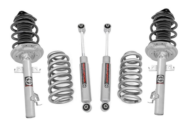

I've got 260k on the rogue and it was time to change the shocks. I found a suspension kit from Rough Country that provided 4 shocks and lifted springs for $600, so figured give it a try. here's some pics
Ride quality is actually improved and got added ground clearance which is a plus.

Nice upgrade, did the same to my 2020 Rogue. Been driving for about 20k miles now with this setup and no issues.
2020-nissan-rogue-s-build-alfalfa-t630225.html
Just remember to do a wheel alignment.
By the way, nice rotors. Where did you get them?

Oh yeah. Your thread is actually where I found this kit, so thanks for that.
Got an alignment already. They couldn't dial in the rear due to rust but front is all good.
Rotors are HAWK TALON purchased from Tirerack. Also changed out the front calipers. Rides like a dream now. Steering got a bit heavier though.

yeah that steering might just fall into a nice nimble feel after a few hundred mi
