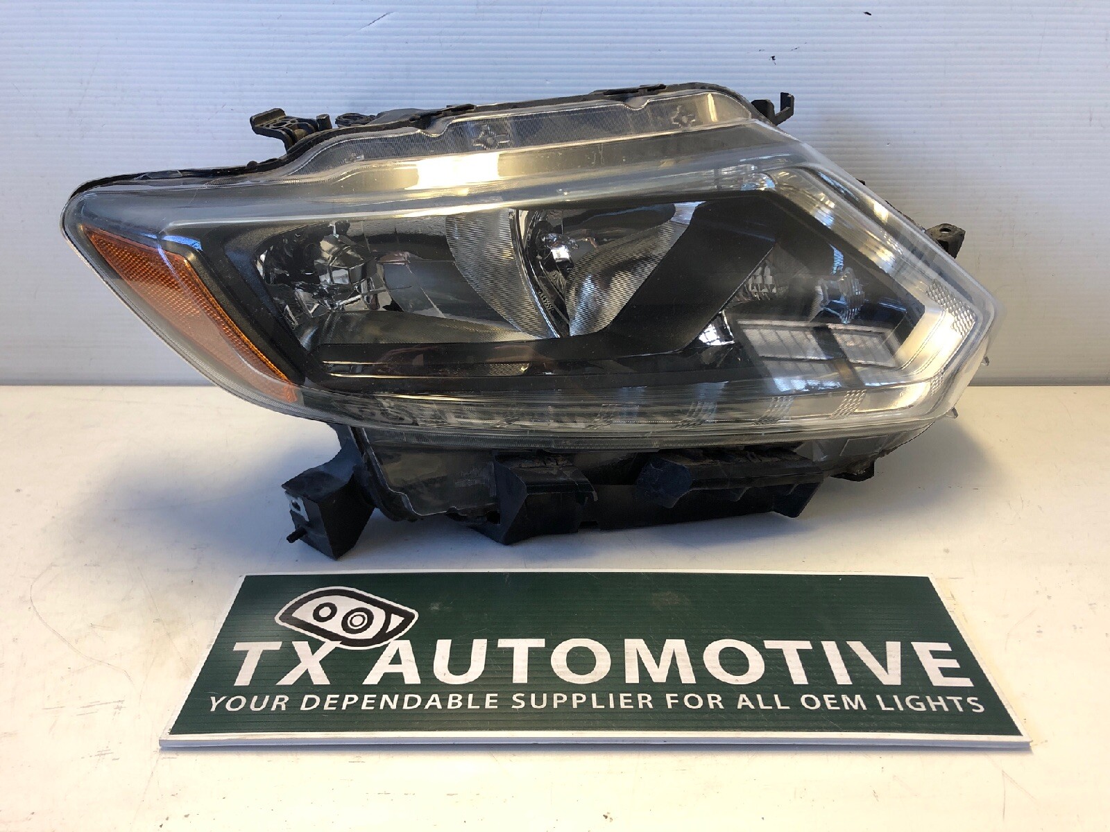

EBAY much? Buy used parts pulled from wrecked cars.
2014 2015 2016 Nissan Rogue Headlight Right RH Passenger OEM US $99.99 Shipping: Fast 'N Free
