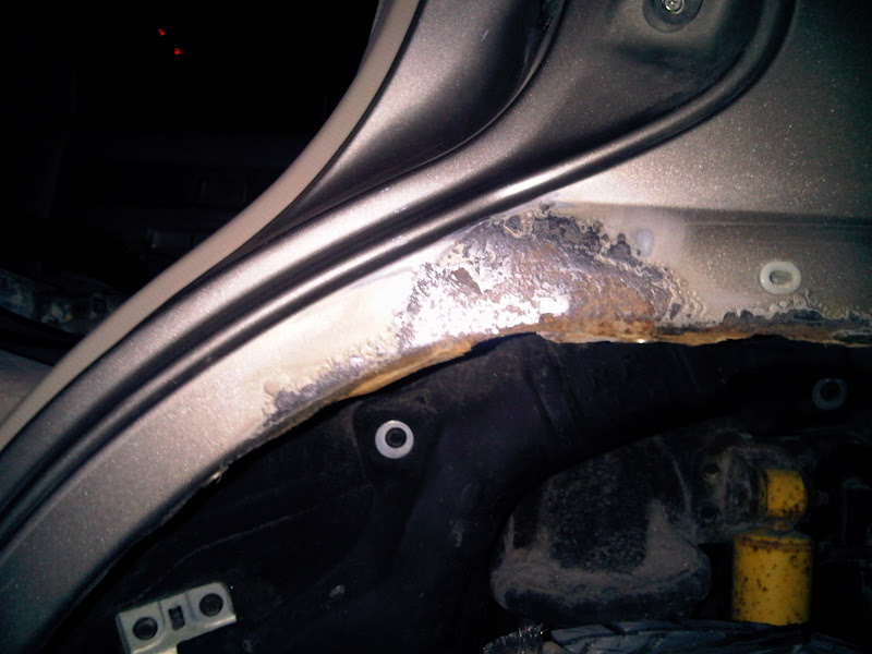

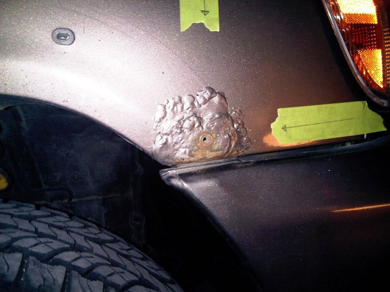

Behind my front and rear wheel well body molding were lumps of what appeared to be rusting quarter panels. So I decided to take them moldings off to have a look and this was what I found. So I am on my way to carry out a fun project in body work.
Rear Wheel Well - I've started to sand it down
Front Wheel Well

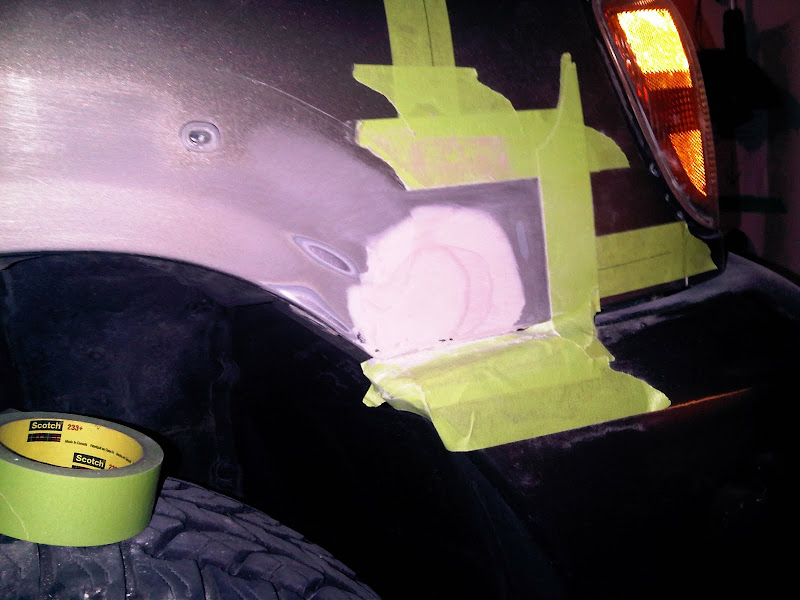

I watched a few youtube videos on body work then went to the local Canadian Tire and bought some tools & materials: sanding block, assorted sandpaper from 180 to 2000, assorted drill-mounted steel brushes, Bondo, masking tape, repair tape, polishing compound, polishing pads, and a random orbital. Total cost: $130. Local body shop was going to charge me $600. Gonna find out if the savings are worth it.
My paint color is only available in touch up size at Canadian Tire so I had to order a can and clear coat from Paint Circuit (Victoria Park/McNicol in Scarborough) and it will be ready for pickup tomorrow. Cost: $47. Running total: $177.

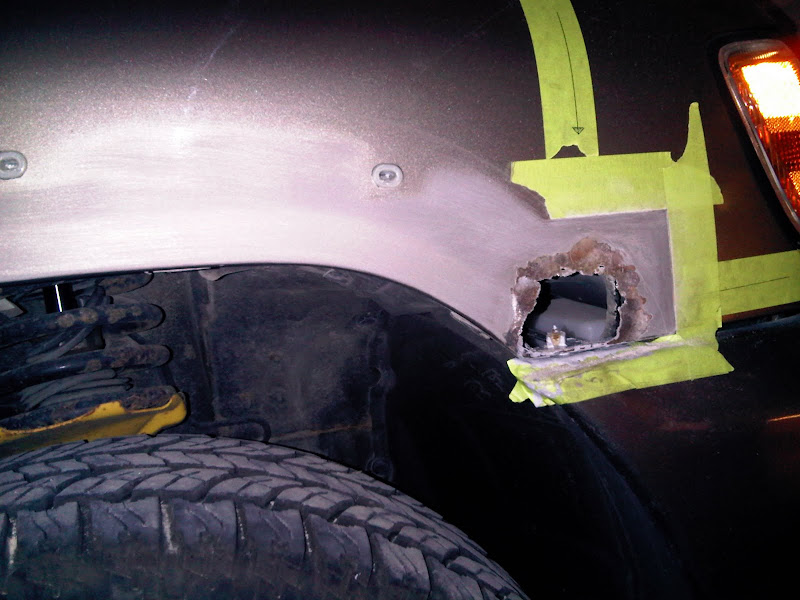

So tonight I started masking and sanding. I started with the steel brush and worked my way up to the 600 grit sand paper. Then I added some body fillers and sanded some more. For the hole in the front, I had to use the repair tape then filled it with body filler. Below are the results.
Rear
Front - when I sanded it, the rust spot caved in. I had to use repair tape.

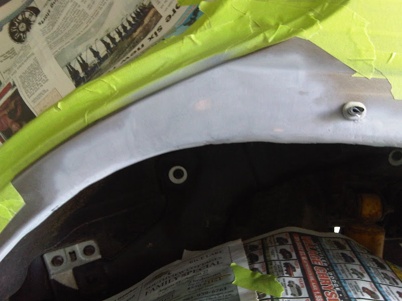

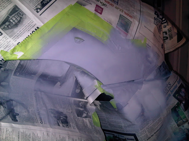

It is chilly and rainy today. I picked up the paint and clear coat but it's not really ideal for doing any paint work because my garage is now moist. I'll move my heater into the garage. I have done some more sanding, glazing and primer on the front. I plan on drilling a hole for the mounting clip and have drawn arrows from different directions to identify it's original location.

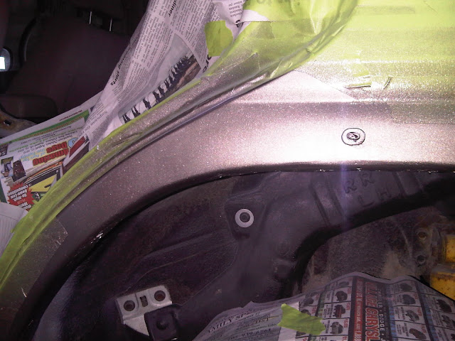

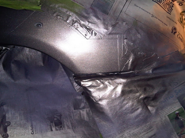

This weekend, I tried to finish off the body work by applying the paint and clear coat. I screwed up the clear coat on the front so I had to remove the clear coat and paint using acetone ($4) then repainted it. Here are the results:
Rear
Front

Interested to see the results after the tape is off.
The touch-up paint I used just looked "wrong" (probably because it's metallic) and no matter how I tried to feather it, in my eyes it just stood out. Whenever I asked people if they noticed anything funny, nobody ever did until I pointed it out... but I knew it was there. So it just ate away at me.

Nice Bodywork!! Can you send the link or describe in more detail how you filled that rust hole. And I too am interested in seeing what it looks like with the tape off. Tried a repair like this on another vehicle and it came out looking absolutely horrendous. Clearly I had no idea what I was doing and it showed.
