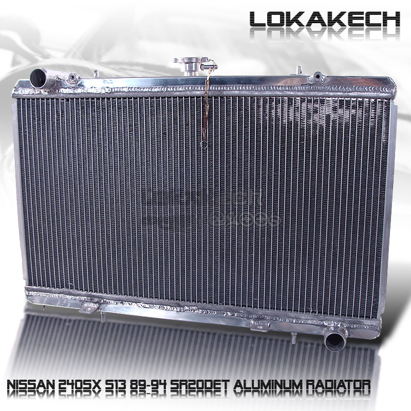

i bought a radiator from a company that should of looked like this http://dnamotoring.com/dnamotoring/imag ... SX-RAD.jpg
instead they sent me this http://images.channeladvisor.com/Sell/S ... D-N120.jpg
is there a radiator hose part from autozone, or pepboys that i could fit this on my 91 dohc

Looks like you got a SR radiator and not a KA radiator.
The bottom hose is the same, just go to autozone and find a top hose that fits.
EDIT: Now that I look at the KA with a SR radiator thats a lonnnnnnng hose on top.
I would send it back.

eww those welds

You'd need to make a cross pipe or find a really long radiator hose. You'll have to run without a fan shroud as well.
