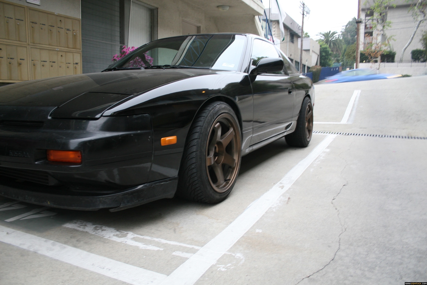

simmode1
Posts: 7918
Car: Red '95 S14
Location: Euless, TX
Well, OP... you pick.
Here's a 225/45 on a 17x9:
Here's a 235/40 on a 17x9:
ZenKi_S14_
Posts: 5
Joined: Thu Jan 27, 2011 6:41 pm
Car: nissan 240sx
Hmm yea I kinda like the 235/40 better, thanks for the pics
