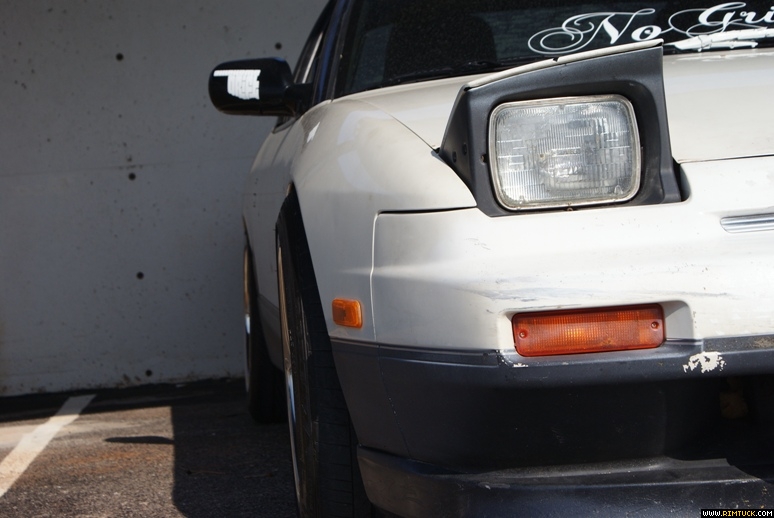

make sure you guys remember clearance of your coils to the rim as well. A 17x9.5 +15 which would be the equivilant to like a 17x9 +25 is very very close to the coil almost touching, if you are running s13 lower control arms, s14 lower control arms will help a good bit but the wheels are also gonna stick out more.
Here is my fronts 17x9 +9 with a 205/40/17 on S14 LCA's it's probably alot more camber and more aggressive than you are looking for but you can use it for reference
